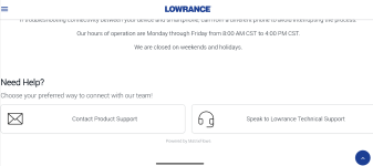

53,339
you can still contact lowrance. just have to do it via their website. if you go to the bottom of their screen, you hit the contact us link. from there about a dozen screens later, you get to the point where you can email them or chat on the computer with them regarding your Elite X
I never get to that point..... I just see "Sorry, there are no contact options available at this time." ???

53,339
seriously
go to the website, and scroll down.
you will get a menu
pick product support
then pick your specific
then pick troubleshooting
then scroll down and chat with a live agent

Thank you - if I pick my product (Elite FS) there is no support offered. However, choosing a higher end product takes me to the contact options you have shown. So, thanks for pointing that out, I will try to reach out to them.
