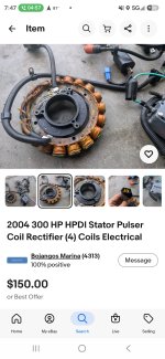

Yamaha 300 HPDI is also a 50 amp stator
They're also bigger and the center may be removable.

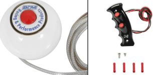

so unless you have Popeye forearms. think outside the box (here is what I came up with about 15 years ago when I injured my left knee)
use a push button on the shifter with a hydraulic throw-out bearing, a 3-way 2-position valve and a flow control on the exit side. easy peasy. instant clutch in, controlled release (flow control).
tie into the power steering pump for pressure and return.
can do a 1-button or two button control.
with two buttons, you need a second valve, however you can have two rates of clutch release.
a HTOB needs between 900 and 1300 psi to operate
power steering pumps in fords are 900 psi, and in GM trucks (and boats) are ~ 1300 psi
great suggestion
based on spelunking around Ebay, yes, the cover coil is removable.
the main stator has about a 4-3/4" ID by counting the lines on the interlocking floor (we have the same in the lab at work)
this should work.
and nearly a 8.0-8.5" OD based on this.
so next is to get my hands on one .
