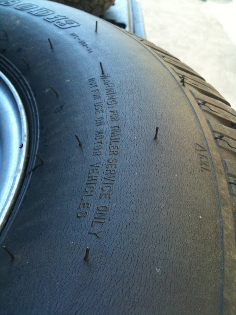

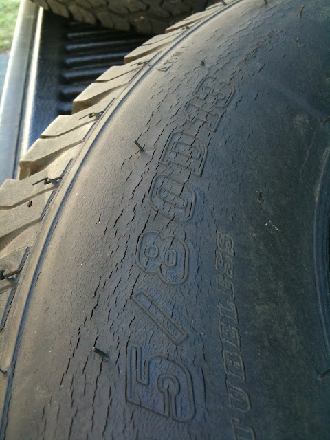

I'm replacing the Duro load-range D bias-ply tires with new radials this year due to some dry rot. The tires I'm replacing are only about a year & a half old, but one is really bad. The other is showing some tiny cracks, but it's nowhere near as bad as the other one.
My question is, can I use the better one as a spare or are both of them just too rotten to use at all?
Here's the really bad one:

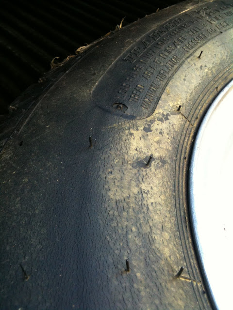

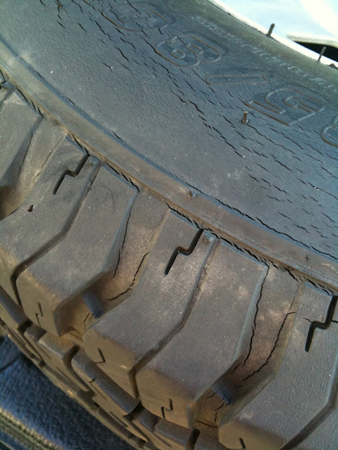

Here's the not-so-bad one (this is the one I'd like to use as a spare):
I'll be using these rims for the new radials & putting the spare on another rim I have.

It will be ok as a spare but should you need to use it, make darned sure you slow down and be aware that there is one questionable tire in the mix.

Keep the sun off that spare or it will look like the other tire in short order.

Yep. Pretty sure it's all sun & wind that got to it. I'll be hauling the next set off to the basement for winter storage instead of leaving them on the trailer. Might look into some covers too.

NO. That is what you call a maypop. You to not need that for a spare.

Boy, you guys have some rough conditions going on there...1.5 years old and it has sun checked that bad!!!!
I would not even attempt to use it for a spare, I spend a lot of time on gravel and with that type of cracking, I am sure I would have a flat real quick...

Honestly I would not take a chance on them, I usually replace tires at about 6 years even if they have good tread because by then, they all start cracking, even Michelins. I have a set of Load Star bias tires (Kenda) on my old Load Rite trailer that date from 2004 that look great, though, not one crack anywhere on them and I never covered up the tires. I think the Load Stars are one of the better trailer tires....

Think of tires like a motor: They reach an operating temperature in a fairly short time and then maintain it. So it doesn't matter if it's 20miles or 150 miles they will reach the same temp and when cracked like that will seperate. They will reach that temp faster when loaded. I wouldn't use them, when they blow and rip off a fender and tear up your rig you'll wish you hadn't. Cracking is worse than have no tread.
