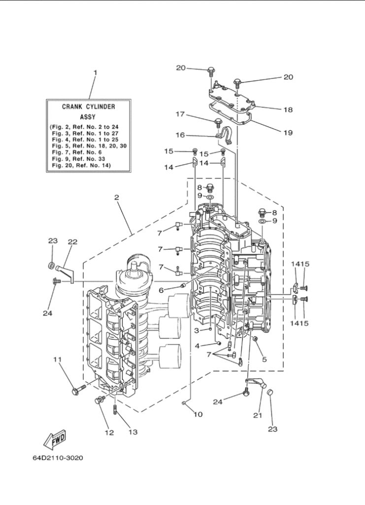

Motor is 2003 150hp 2 stroke carbureted. I am trying to find out if this hanger is the only place that I need to clip to to lift my motor and set it on a stand. Also, the hanger is set back from center of the motor. Seems like it would be a little off balance if I clip to this. Should I trim the motor up like this guy has done?
Lifting hanger is part #16 on this diagram. Sorry about the small picture.

Anything that big I will lift by the flywheel bolts or make an eye that bolts to the crank

I agree with this statement. I just wonder why they would put a lifting eye on here if they didn't want us dummies to use em. I will have that motor up for maybe 2-3 mins as I get it onto the engine stand.

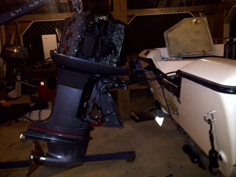

sutor623
May 23, 2011
4,089
Got her off and onto my stand safely. I used that hanger and actually I felt very comfortable with it. Only hung from it for about 30mins. while I got the hardware unbolted and the BENT teleflex steering cable out which was a real PITA. Anyways, thanks for the quick replies. I agree that using an eye on the crank would be ideal, but without having one, this worked very well for me. Thanks again!!
