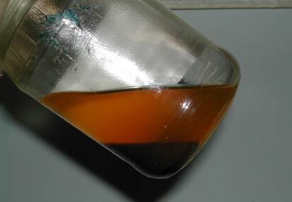

I think smokeonthewater has it correct...
here's a photo of gas where the ethanol has become saturated and fallen out. I keep my tanks full.
