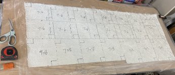

Mass production of gusset fiberglassing . . .
I have over 20 gussets to glass in. I tried a couple of them 'free hand' and the results were OK, but not great. So, I made a template on my computer and laid them out on a large piece of 1708 cloth.
Don't tell anybody, but I lightly glue a sheet of plastic to the '17' (biaxial) side of the cloth, so the pieces stay together and don't fray during the cutting, handling, and wet-out.
Here is the 'master' sheet with all the gusset pieces marked.
Then it was a matter of cutting out the individual cloths.
I did the secondary stringer gussets (12 of them) fairly quickly and can get the others in the AM.
