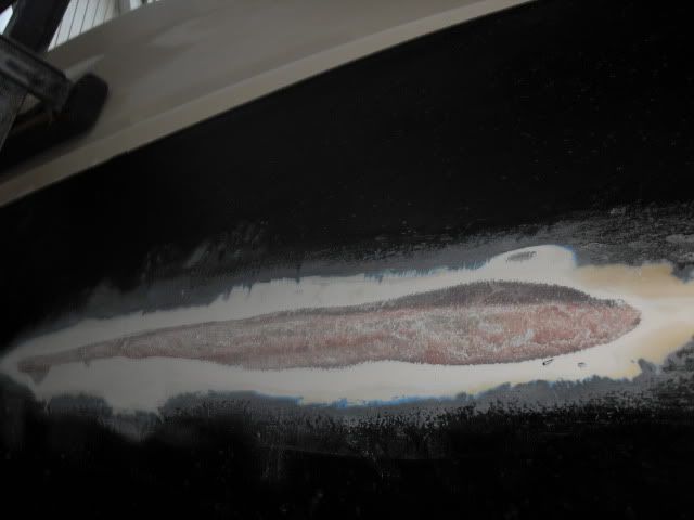

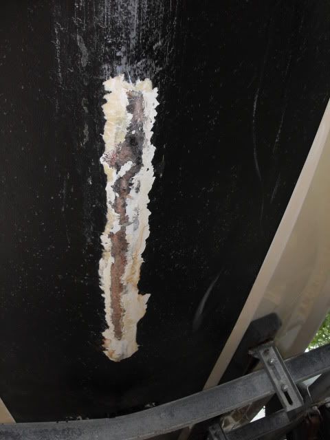

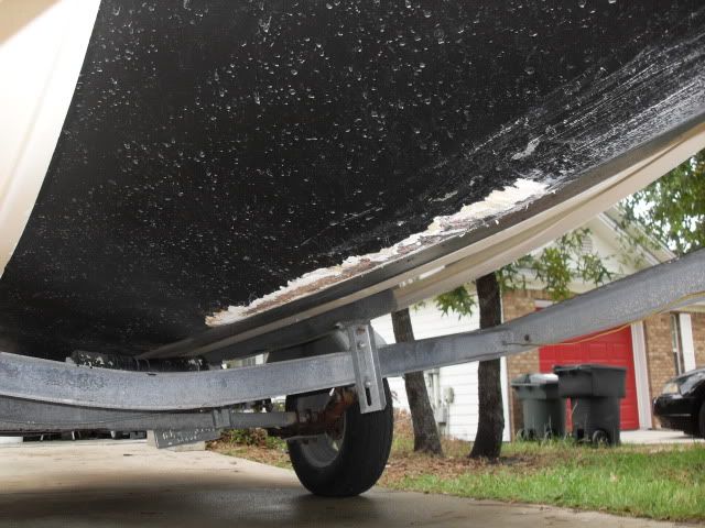

A few months ago my father and I purchased our first boat- a 1997 Key west. So far we have been working out the kinks and getting it in shape. A couple weeks after purchased we noticed the Keel Guard coming loose...so I went ahead and pulled it off to inspect. Nothing special...looked like an old repair that had been painted and covered by the Keel guard. Next thing I know I have paint chips in the driveway and upon further inspection and scraping I have this:
I went ahead and scraped off the remaining paint and old fiberglass from the repair area...it was old and brittle. It looks like the total repair area is about 26" Long, by 4" Wide.

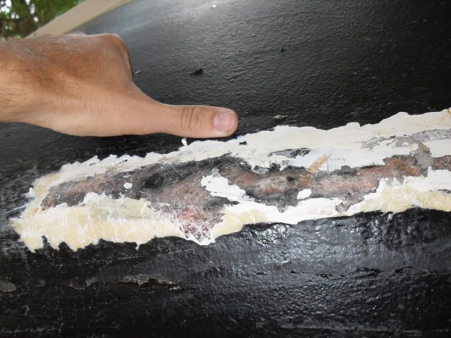

Here is a photo upclose...You can see the fiberglass of the boat...and it is somewhat wet so obviously water has been getting in.
Can anyone chime in on the best way to tackle this repair? Let me preface this by saying im not worried about looks, as much as I am functionality and safety. Should I just sand down the area, repair with fiberglass resin, then cover with new Keel guard?
Ayuh,... Sand it out to about 6"x 30",... Lay down a 2" strip of Glass,... Then a 4" over that,...
Sand smooth,+ paint, or keel gaurd it,.. Your choice....
I'd probably use Epoxy for the resin, but Polyester will probably do....

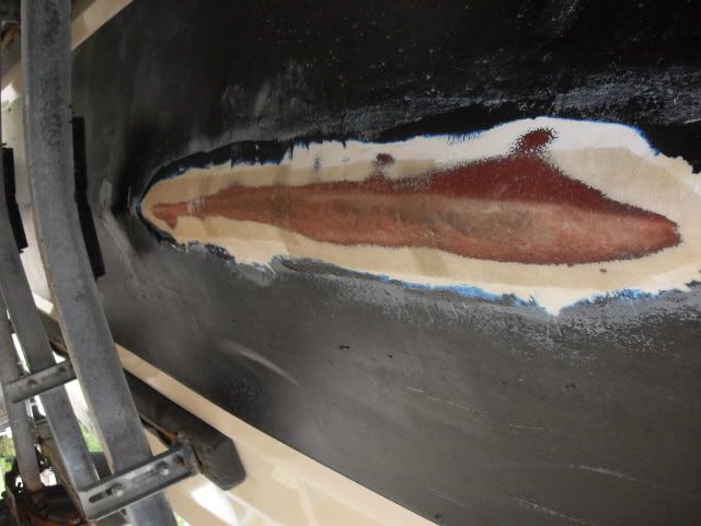

Update:
I have started the sanding of the old repair and rough edges of the working area. I used 50 grit sandpaper and this is what the area looks like now:
I think I will use a Polyester Resin as suggested (thank you)...however that leads me to my next question. What type of fiberglass should I use?
Standard fiberglass Mat? (Then cut into 4 inch wide by 30 inch strips?)

Re: Hull Repair...need help from the experts
Seminole hello again, Yes poly with 1 1/2 mat. Maybe 2-3 layers. It does'nt look like it is down into the structural cloth. Meaning Roven. When you grind/sanded off delam, did it appear to be only mat? It really doesn't look big enough of a repair area to warrant stuctural cloth. [Biaxal/woven-roven] Layup enough layers so that it is level with rest of boat. Grind level once cured. Even though you want to put a keel guardback on you should still seal bare glass with gelcoat. You can brush it on and leave it if you want. Remember to put surfacing wax in Gelcoat so it drys tack free. Good luck Happy and SAFE boating Jon

First off.. your last pic showed that there is Delamination in your fiberglass. just for fun take some acetone and wipe your repair .. see all of that white fiberglass.. that IS Delamination. Your gonna have to grind that out m8. while grinding if you see lines that your grind dust makes, that is representation of stress cracks. ( polyester is static and will show you most of your repair area).
This is what I suggest .. grind out all of the white dead glass, bevel, layup using poly " lamination" resin 10 cc per quart catalyst . Starting with 1.5 oz mat, build using roving woving ( .5 oz mat backed or you have to use mat between layers ). no more layers than is needed to build up slightly low..last layer(s) in mat. Grind/sand till faired out. if needed for existing lows use your mat torn up by hand into little 1"-2" circles and resin. ( why buy filler when you already have the best filler avail. ? ) sand till fair with 80g paper. Wipe clean with acetone..coat with resin again ( DO NOT use wax at all in any process .. that is only for bilge and compartments..not layups ! ). sand smooth reprep , apply your keel guard and paint to edge of guard. do not put your guard over bottom paint.
This is the proper way Fish .. Good luck and regards.. YD.
