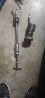

1) Slide hammer
This has 3 jaws that go through the bearing and expand outward with a collar. It grabs the bearing from the back. You slide the weight hard and fast against the stop to bang the bearing out. The weight/slide weighs 2 ½ lbs. That did not work.

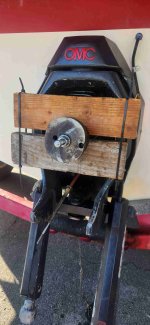

I also have a custom bearing puller with a long shaft, a way to brace it against the gimbal assembly and a nut that you turn. It works just like the official tool. See pictures. That did not get the bearing out either but there were 2 pops, so something may have moved. I was torquing on the nut to maybe 50 ft-lbs. (pretty hard with a 10 inch Crescent wrench) Never having done this before and not wanting to damage anything like the gimbal, I stopped.

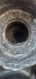

My next step is to drill out the bearing. I have been told that works but I want to be certain that I know exactly what to drill. Below is a picture of the bearing with the parts numbered.
Which one do I drill out? Any other suggestions?

I've not seen anyone try to drill out the bearing, and I see a pic of the slide hammer and puller but not the bearing.

The second picture, called GimbalBearingNewCompressed is looking right at the bearing. I have tried hammering it back in, then banging it out, back in etc. It still does not come out.

spray with a penetrating spray, the with the pic of the puller .replace the wood with 3/4 or 1inch steel
KM7
Aug 14, 2013
352
I have been spraying with "Big Blaster" a penetrating spray for 3 weeks.
Re replacing the wood with steel. The strength of the wood has not become a factor. I was concerned about damaging the gimbal with the load that I was putting on it. I had gotten to the point when it was very difficult to torque the nut on the puller. That must be putting thousands of pounds of load on the bearing. Maybe that is what is required but I'd rather have a professional tell me that.

Looks to be salt water area and bearing has welded itself
Bearing was put in backwards, you can remove the center of the bearing by rotating center piece to left or right, then pull it out. It will give less area for puller but may help
The outer part of the bearing is aluminum

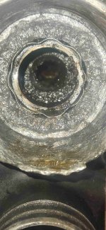

Update !!! I got the old bearing out! It took the OEM tool to do it and a good amount of torque.
Now I'm cleaning up the housing where the bearing sits. Yes, there was a lot of corrosion.

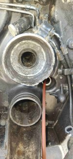

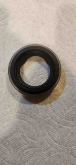

The gimbal bearing is out!! Next, I'm replacing the seal behind it. It is called the gimbal bearing oil seal or Seal, Driveshaft, part number 0911795.
Surprise, it is also stuck!! I have remove the rubber portion to expose the metal and have pried it away from the housing. See picture. Any suggestions?

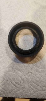

The seal is out!! and I have cleaned up the race (?) for it. I'm ready to reassemble. I assume that the rounded edge goes into the cavity. I have loaded 2 pictures of the seal. The Rounded edge showing and the Sharp edge showing,

I found the answer: Yes the rounded edge goes IN leaving the open side out, facing aft. That was in my official OMC Service Manual. P 6-11 . The manual also says to coat the metal case with OMC gasket sealer. Since I do not have the official tool to install it, I decided that I can use the old bearing as a guide. I will tap the seal in the recess to get it started and then put the old bearing on top. I will use the back of a wooden hammer and then tap the seal into place using the bearing. I will work around the circle tapping Top, Botton, Left, Right etc.
