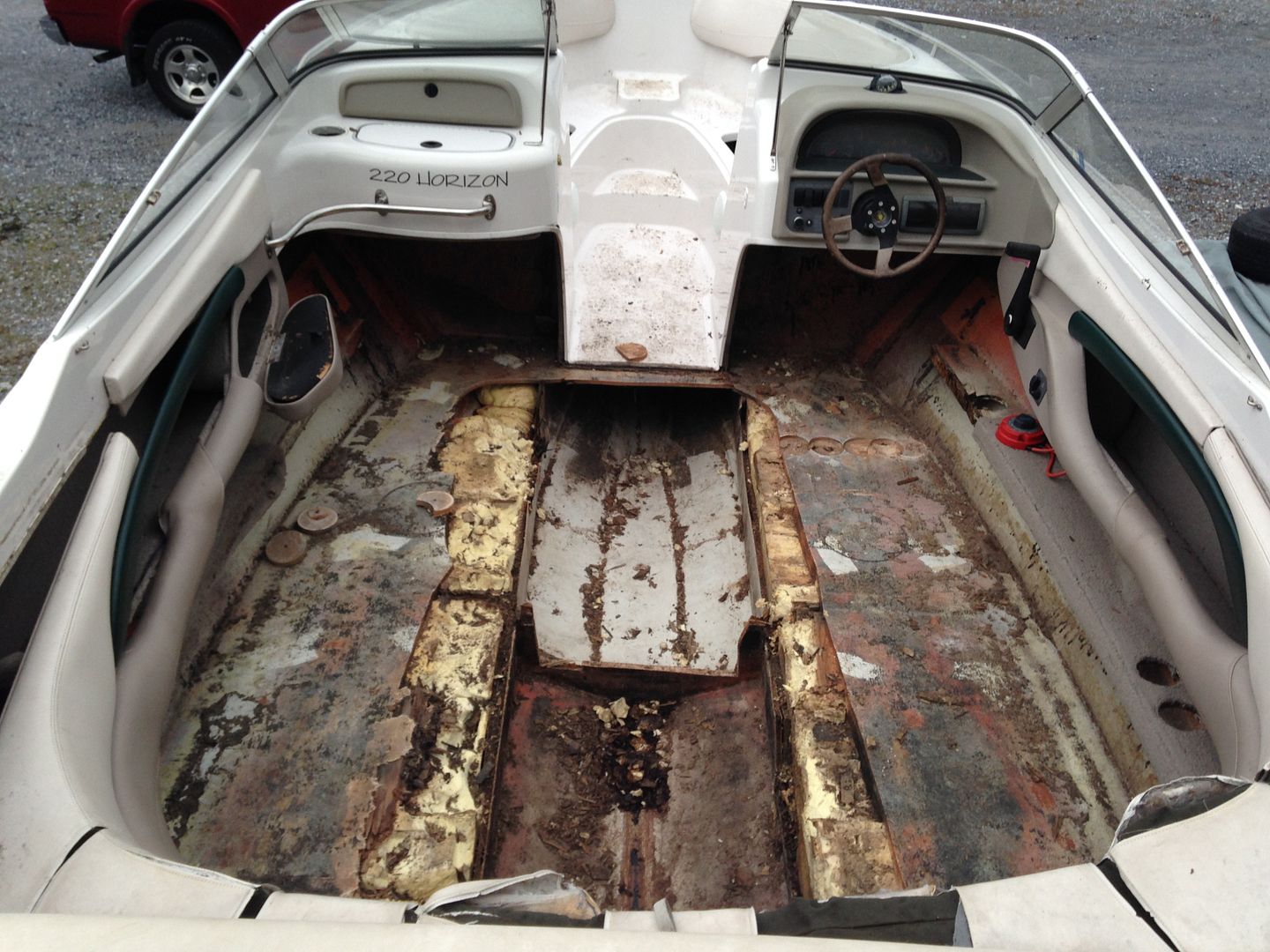

The boat in the picture is the actual boat. 1996 Four Winns Horizon 220 with a Volvo Penta 5.0 Fuel Injection engine.
Yes, it absolutely is rotted, the more I remove the more rot I find. :confused:

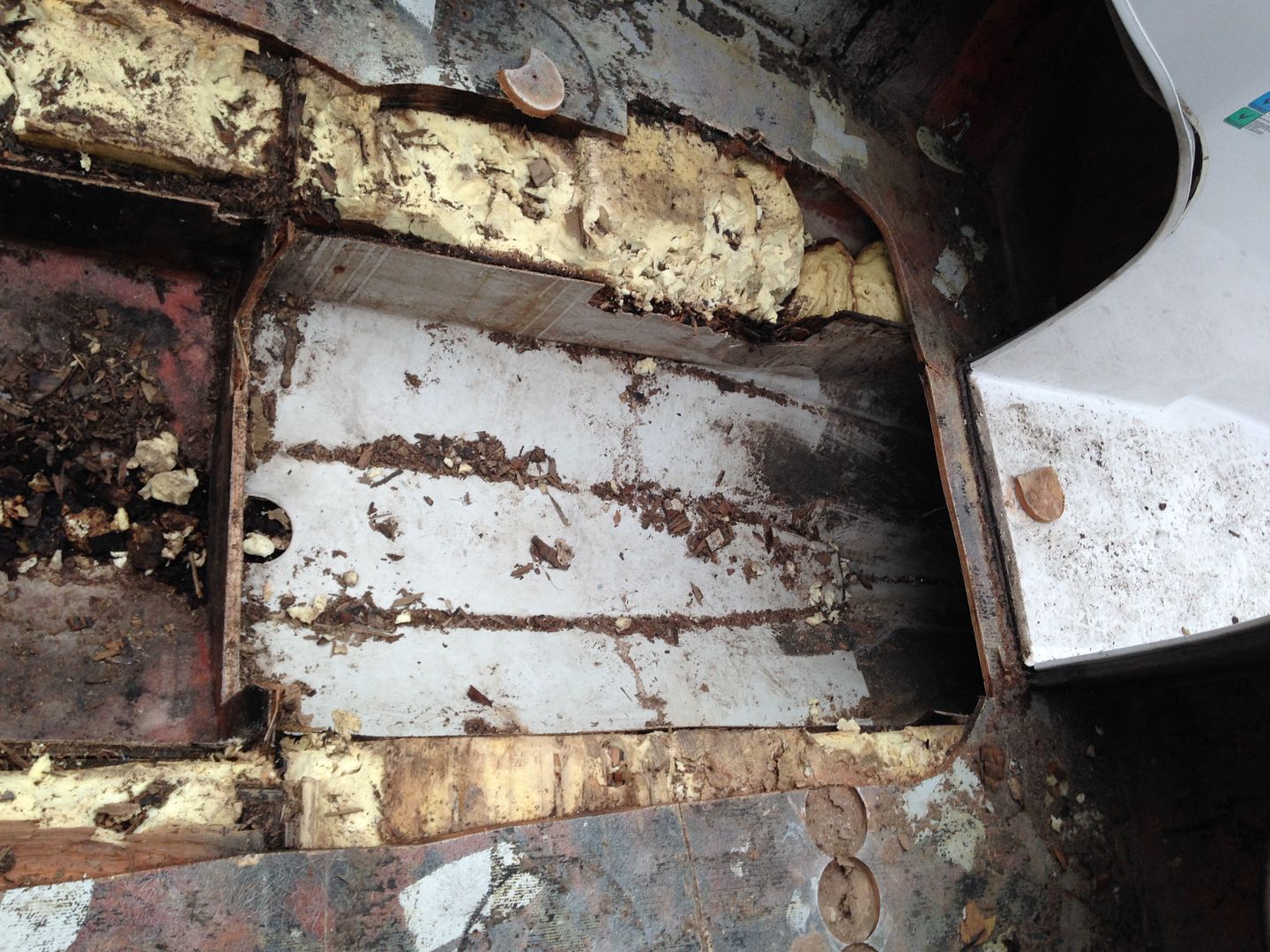

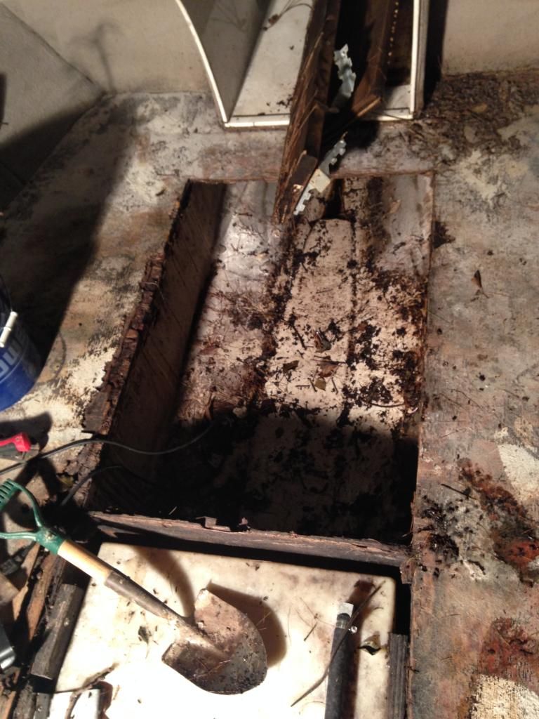

I was drilling small holes in the entire floor to make sure I didn't cut the stringers but it looks like the sitting water may have bypassed any fiberglass and foam straight into the wood. At least that's what I'm finding so far... any chance the stringers are completely dry and usable?
The good news is - look at the outside (it's my glimmer of hope). The leather and fiberglass is in tip top shape. I have all the pieces and I know it sounds like I'm oversimplifying things but it's just a little 265 HP Motor and some wood....right :joyous:? 100 hours on the engine and there was no gas left in the gas can.
That has to be good news right?

Hi New, we still aren't seeing your pics. If you're seeing them it's because they are cached. Most reliable way is to get a free photobucket account, upload there, copy the IMG link and post it into your text. You can set your circular saw to the thickness of the deck or slightly less that way you won't have to worry about cutting the stringers. Hope for the best but plan on less for those stringers! Good luck.
jigngrub
Mar 19, 2011
8,155
Your transom is probably rotten as well, so you need to figure that in too.
That boat needs a lot of work and some money invested back into it, but I think you got a great deal for $500.

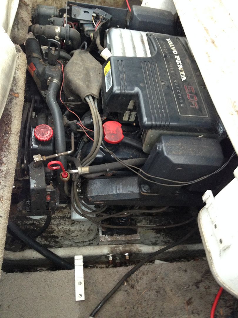

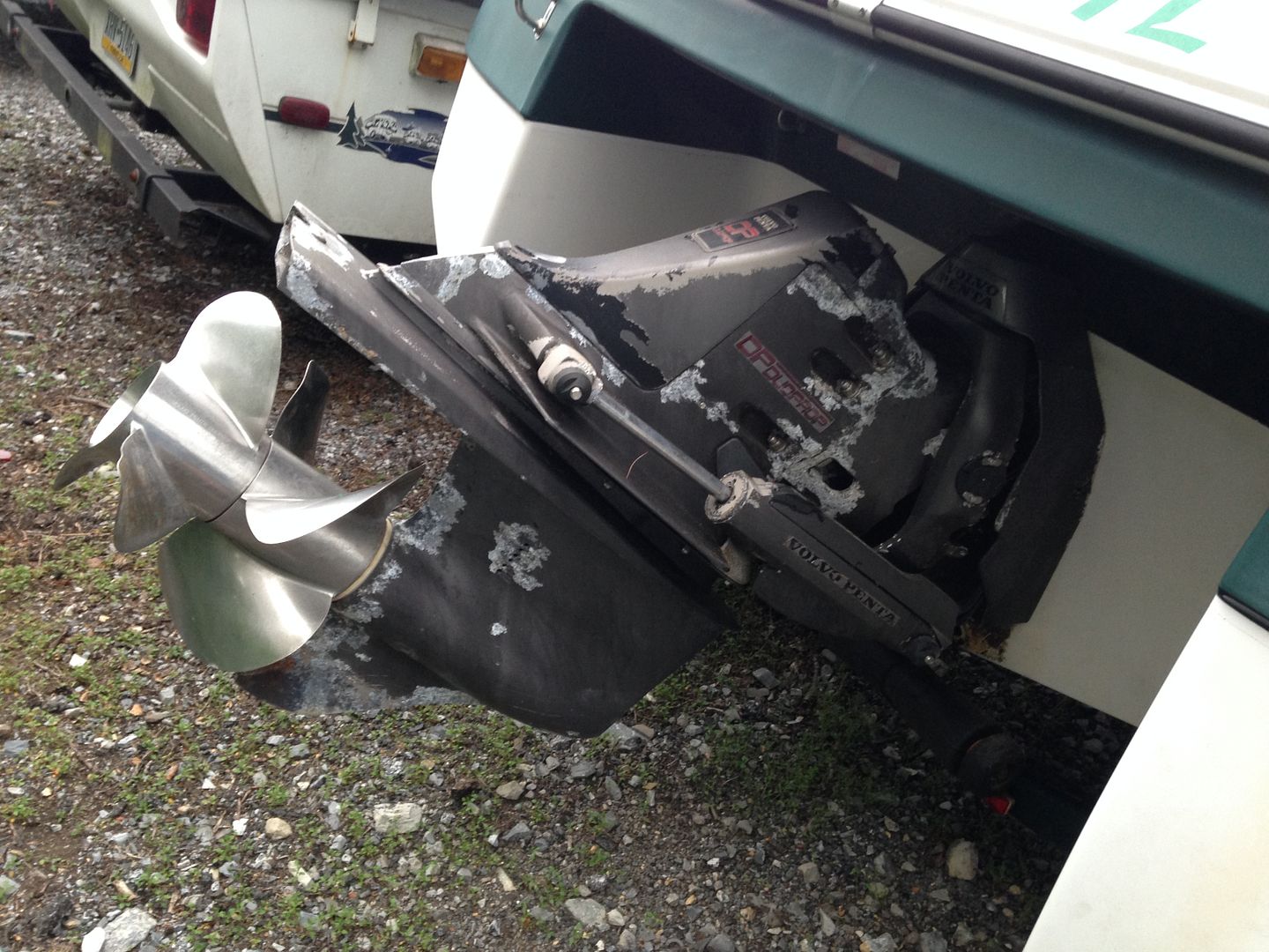

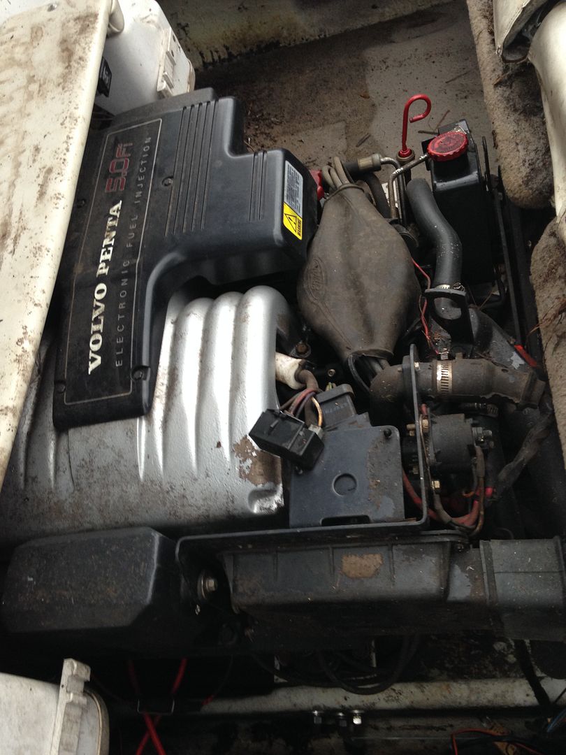

Ok feel free to critically analyze the following pictures Propeller, this corrosion? Is this Sea Water corrosion? This engine looks ok right? Repairable? Lastly here is a picture of the engine mounts. The engine intact and it looks separated from the main stringer. Any reason why and does this mean I can replace them separately, like when I have an engine lift?

The propset on there looks like it needs some attention, and replacement of that set is rather costly, however, that duoprop drive is worth way, way more that the 5 bills you got it for....you will most likely need to pull that ford to fix the substructure, so you will have plenty of time to tinker with it. While its all connected, you may want to change the fluids, and get her running, and check the trim/tilt and other items before yanking it.
Looks like a good resto candidate
