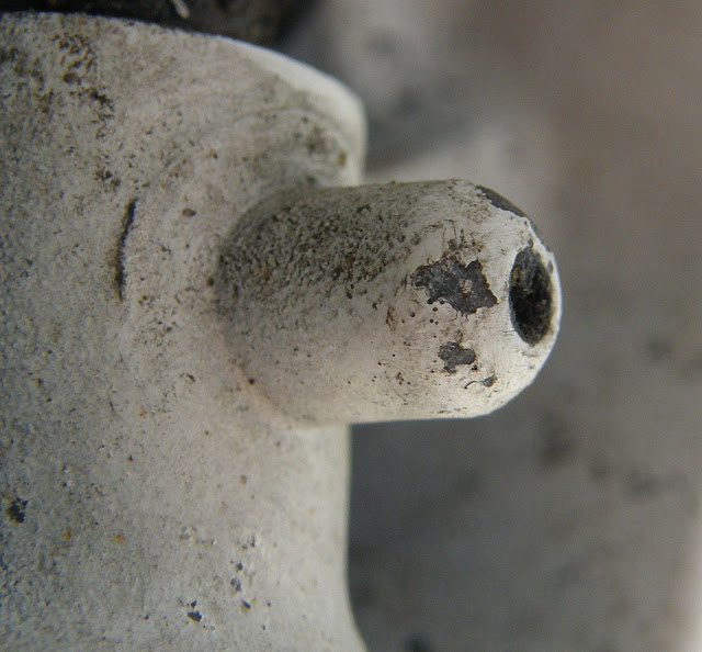

Where can I get a grease gun nozzle to grease the cast looking nipples that are not zerk fittings on my outboard ? I went to auto parts places and they never heard of them. I have good google skills and can not find anything online.

85 Johnson 9.9
Talking about the nipples for the steering and transom hinge areas.

Here is a pic of my fitting.

I know exactly what you are talking about, and you are 100% correct. OMC dealers sold grease guns with rubber inserts in the tip that you merely pressed against the end of the nipple and pump away. However, I haven't seen one in years.
A regular zerk gun will work in a pinch---sort of. Another idea is go to a chainsaw dealer. They have grease guns that have a pointy tip for lubricating the roller tip on chainsaw guide bars. Stick the pointy end in the hole and pump away.

Your grease gun should be fited with a flexible hose or a solid "pipe" with fitting on the end to attach to a zerk.. Remove that and buy a 6" long piece of galvanized pipe threaded on one end. Obviously, the thread should be the same as your hose fitting. I think its about a 1/4" pipe, but I didn't go out to the garege to check.
Anyway, file down and smoothen out the non-threaded end with a small round file, so that it fits right over your fitting. Then when you use it just push down hard to keep the grease from squeezing out.
The original OMC gun had a nylon fitting on the end, and with only a small hole. My old filed piece of pipe has been greasing my Rudes for 40 years without a problem. Leaves a little more grease on the outside, but you can wipe it off in a second.

I have used a regular gease gun on mine for 20 years and have never had an issue. Just hold the grease tip tightly to the fitting and pump.
That's exactly what I use on my 84 9.9 and it works great on those fittings.

I too know what FR is talking about. It was a pusher type pumper that you would attach to a tube of grease and was tapered on the end to fit over the fitting. I still have one in my tool box.(Somewhere?)

I've been using the same grease gun and grease for both my bearing buddies and my 35 hp for 30 years. You just have to hold the grease gun nozzle on the motor nipples because they don't have that locking groove of a normal zert fitting.

Remove the tip of grease gun and clamp a small piece of rubber hose on the pipe end and press over fitting and pump away.

I use a small rubber washer on that type of zerk, and a regular grease gun.
The rubber washer seals well enough to grease those fittings with a regular gun.

Re: Grease nipple not a zerk
