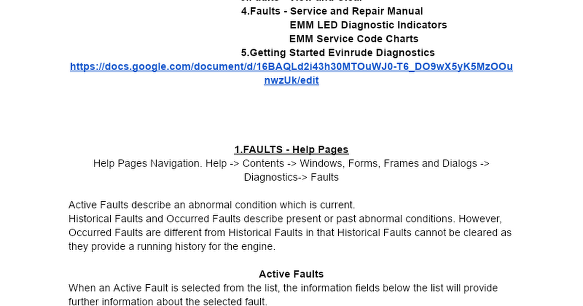

I consulted the Etec owner'S board and learn that the fuel pressure issues wont show on the EV diagnostic.
The only sensor for the HP pump is a current sensor monitored by the EMM... it can detect OPEN (no current) SHORT (excessive current). there is no fuel pressure sensor)
btw.. replacement pumps non oem can....and have generated fault codes due the the pump current load not meeting EMM expectations....something to consider :unsure:
this is typical of other components where mecanical failure is the cause.
ex: a stuck injector will not be reported by the EMM but an open or shorted one will be.
TPS and CPS are monitored andwill generate fault codes.
