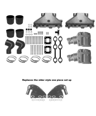

What does replacing the manifold cost?
It’s a conversion so you need a whole kit. I think Barr Marine sells an aftermarket kit for about $1200 then you have to add labor unless you can do it yourself.
About $700. Your exhaust bellows looks suspect, can't see much of the u-joint bellows, which is where the water would enter. I'd pull the drive anyways to check u-joints, gimbal bearing, and alignment. You'll also be able to see if the inside of the bellows are wet (and then you'll need to replace a bunch of stuff).

For the conversion you need additional parts in addition to the manifolds and elbows. There are 2 exhaust pipes that adapt from the elbows to the Y pipe and 2 rubber hoses on each side to connect.Actual price of the complete Barr price which I found on Marine Engine Parts (AKA Lighthouse Marine) is $1118. I got my Barr Marine exhaust from then and made up my own conversion from that and Volvo OEM parts. About the same price mine cost a bit more. Same job to replace the old OMC one piece bat wing exhaust.

However, it would be a real shame to lose an engine that's otherwise perfectly good because someone doesn't know about the ticking time bomb of the Merc one piece manifolds. So now you pay $1118 parts + labor or do it yourself, or $4000-$5000 + installation costs if you can't DIY for a reman engine by the time you're done.
In fresh water this repair is a one-and-done deal probably, we salt water boaters are used to replacing exhaust regularly to avoid engine failure. I'm on exhaust replacment #3 in 19 years.
First pic shows how the original batwings clogged after 5.5 seasons in salt, next 2 are the conversion I did using Barr aftermarket exhaust + Volvo Penta exhaust pipes & hoses. All fit like factory because it was actually designed by OMC and used on the 91 and up Cobras, which Volvo adopted during the joint venture and used all the way to the cat converter exhaust you are now forced to take (no thanks).
