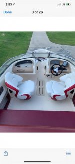

Hello,
I just purchased a 1998 Starcraft 1810 LX and have lots of questions of what I should do first.
I was thinking it would be a good idea to change out the fluids as I have no idea what the previous owner actually did for maintenance. I see 4 fluids. Drive Oil, Motor Oil, something under the motor oil that just says put in proper oil. There is another one that says SAE J1171 Marine. What should I put in these and how should I drain them?
The fuel gauge does not work. The seller said it had been working. What should I look at to fix this? The seller took us out on the boat on the lake for around 3 hours and my kids tubed, and also used the kneeboard and wakeboard. The boat did great, but I could use some advice/tips on how to plane better. Bow was up in the air for 10 seconds or so before planing. Would a wake tower improve planing, or will that only give a better wakeboard experience?
When we finished and brought the boat up on the ramp and took out the drain plug a decent amount of water came out. The seller said the bilge pump must have stopped working and that it had been working. How do I test this?
Also, how do I tell which version my engine is? Trying to find manuals, and not sure if it is Alpha, Bravo etc...
