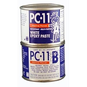

I'd recommend you check into PC-11. Ace Hardware carries it. It's quick easy and very effective for repairing small holes like this.
