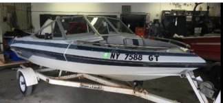

it’s a very shallow hull if that helps. The boat in the pic is not mine but the same hull.

Found a pic. This one is mine. Shows how flat and shallow the hull is at the back.
