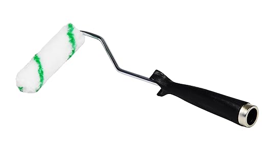

Straps, certainly not an expert here either by any standard or stretch, but I have used 20 gallons of resin now and went through the learning curve as well. I use 4" roller that I got from Lowe's. I roll on 435 laminate resin and soak everything first. Then lay out the CSM and start rolling it into the resin. If it looks like there isn't enough resin from some dry areas, I roll on some more. The roller will pick up the CSM strands if you have too little resin, OR if you keep rolling over the area more then needed. I found out that rolling on the resin and moving along works better for me. It is a learning experience and I would stop using Bondo resin and buy laminate resin for what you are doing. As previous stated, Bondo resin has does have wax in it. While you can use that, the wax will have to be removed if you decide to lay any type fiberglass over top of previous laminate. You can do that with both sanding AND then washing the area using Acetone. I use some Lacquer Thinner as well and that works. But most use Acetone. Even laying fiberglass over the fiberglass you just laid will have to be clean first. Usually folks lap previous areas a couple inches as they lay more. So search the net for 435 laminate resin and buy it from a vender. It will be cheaper and work better. But this is just my $0.02 cents worth. Here are the 4" type roller a lot seems to use.
jbcurt00
Oct 25, 2011
25,356
I just ordered one from Amazon, I'll give it a shot!
I'd cancel that order, no reason to use that roller, unless your putting vinyl flooring down on the deck once you get the glass work done.
If you used a regular paint roller, unless it was a short nap, I'd suspect it would pickup the fibers from the CSM.
