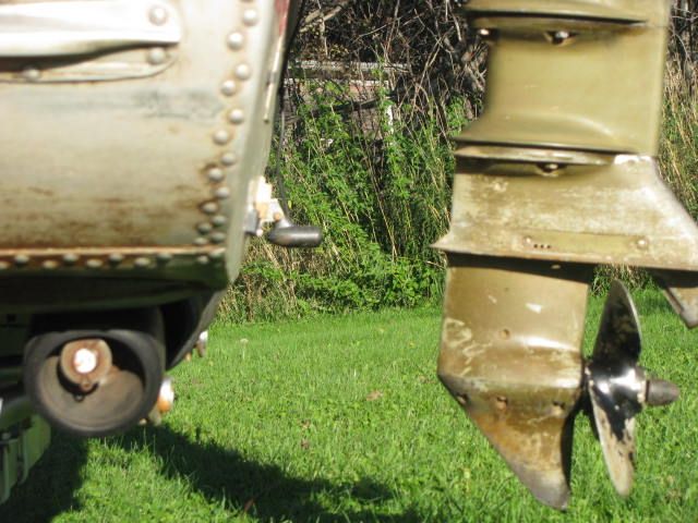

The transom measures 20". The jack plate was added because the cavitation plate sat 5" below the hull. Does this not make the motor an extra long shaft motor?

Only the first pic in this last set is useful to tell the the actual AV plate height, which could be a little high, the other pics are at a slight angle and there is no way to determine the exact relationship of the AV plate and bottom of the transom. As was said before, the exact measurment of the motor may not be 20" or 25", it could be shorter or longer. I can't tell how much the jack plate raised the motor, but if the motor is 23" and the jack plate is set at 25", then the motor could be too high. I say could be, because on some boat and motor combinations that might be fine, on others it may not work well.

To the last person that replied, I did measure the transom. The tape measurement is pictured in the first photos. 19".

Here are the photos asked for.
OP came to talk about what is, and the audience is telling him what it can't be. One or two of the pics seem to make his point. Some are inconclusive. (He apparently doesn't want to talk about condition of the motor.) One or two simple measurements, clearly shown, should clear things up.
Fishdeer, if still interested, I would like to see a couple more pics clearly showing measurements for the transom and the motor leg -- no extreme close ups, or side angles. No confusion regarding measurement points. Just a tape or measuring stick pictured flat on against the boat transom and the motor leg:
pic 1 (boat): show point to point measurement from top of transom at factory cutout to bottom of hull. need to see it all in a single pic, top to bottom, with tape or measuring stick in place.
pic 2 (motor): show point to point measurement from top of jackplate to top of anti ventilation plate on the mounted motor. need to see it all in a single pic, top to bottom, with tape or measuring stick in place.
From what I see, your motor mounted/raised on that jackplate is about where it should be (anti-vent plate about even with the bottom of the boat), as was noted by another poster.
My simple assumptions, give or take a couple of inches: Either your transom is 15", and the motor leg is 20", or the transom is 20" and the motor leg is 25". The latter, I think, is your belief. A couple of pics could clearly show both measurements, so there would be no doubt.

Oldboat1 - he has already done so with the measurements. The transom measures approx. 19", making it a 20" transom. The motor measures approx. 23", which in OMC terms is for a 20" transom. As I have tried explaining several times, the motor IS NOT an extra long shaft. It simply isn't. Period. They never made one. Even if some aftermarket company made an extra long shaft kit for this model, this motor does not have one installed. Fourth photo in post #37 shows the extension is only 5-inches. Suggesting otherwise simply confuses the issues at hand.

no, believe that begs the question, Chinewalker. Know what was said and what the specs. are, but would like to see the actual measurements I described -- point to point.
