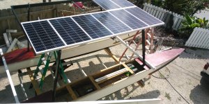

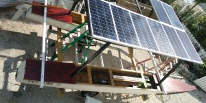

Looks awesome. So what's the total kw of the panels now, and ah of the batteries?
