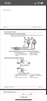

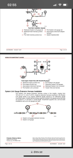

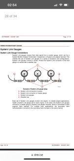

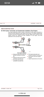

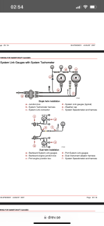

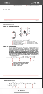

This might help. If you don’t already have it

I am aware of all these diagrams but i have not found anything concerning how smartcraft sc1000 etc is connected when the boat has axius and the smart j-box.
