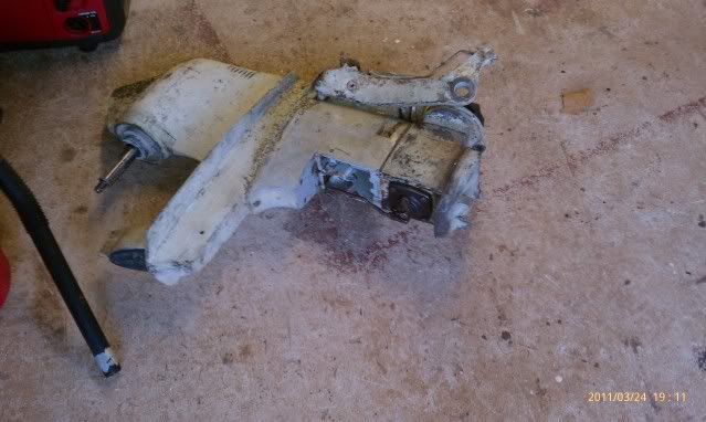

I pulled my 260A with the housing attached. I pulled the outdrive first.

Thanks for the pics Jeff!

yes, as you pull it out, it will look like Jeff's pic above
