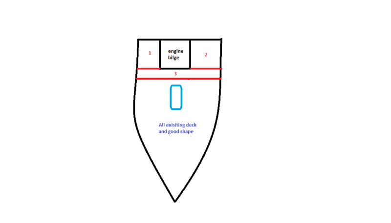

The plan for the boat is this .

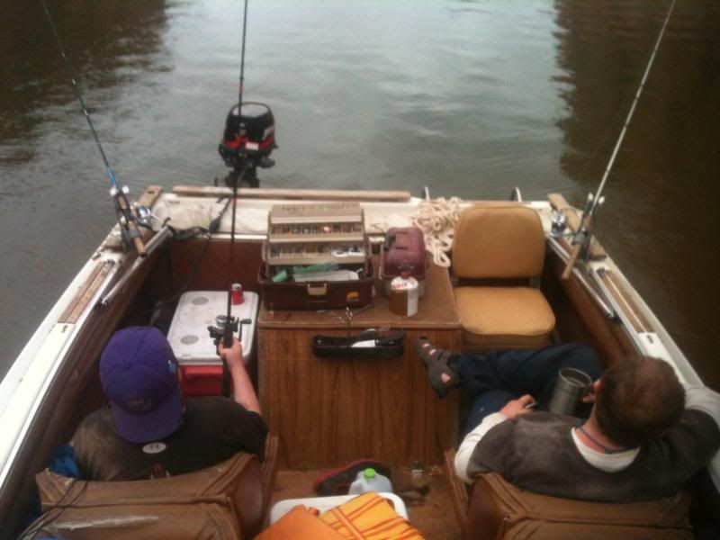

It was ugly late 70s carpet and vinyl in there , I was going to add new flooring regardless and I always wanted more storage in her so I figured I would explore this ski locker idea while she was under going this cosmetic makeover . here are some of the before pics so you have an idea

I have removed basically the last 4 feet of the deck. I was goign to try for some tackle boxes / storage on the SB and port sides under the deck , but it is not deep engough, that is why sections 1 and 2 were removed. also on section 2 thats where the anchor was dropped many times and it was beat up. I also wanted to check the transom while I was there and she is good to go.
sections 1 and 2 are right at about 15 x 40" section 3 is 6 x 58" and I still have not found a ski locker that I like yet . that will be going into the existing deck and I will use access from section 3 to get the foam out , ect. I already have alot of it out.
there are 3 stringers in the baot and the span between them is 15 inches.
before I found out that I had the stringer in the middle I was just going to drop in a standard ski locker in the middle , however now that I have the stringer in the middle I am going to find a larger ski locker and basically use the stringer as a "divider" of the ski locker. I dont want to cut the stringer like my initial plans. I will add the bulkheads once i have the hole for the ski locker cut out.

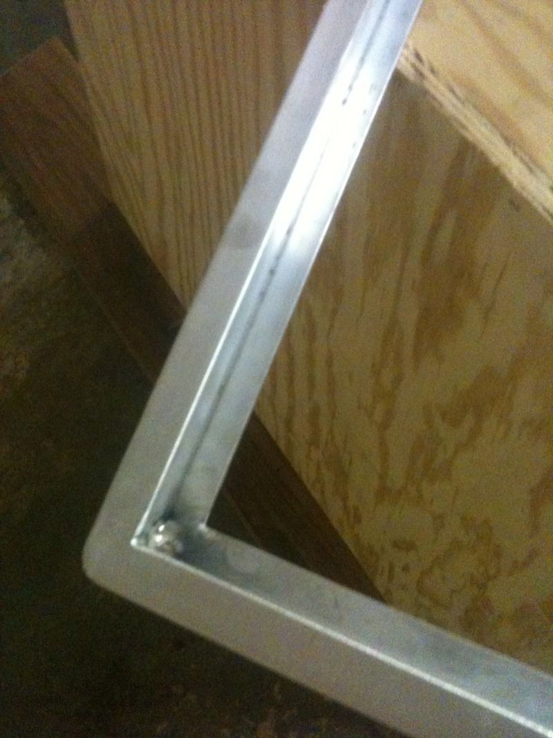

I will upload some pics soon too , I had my buddy the welder build me a nice 48" x 24" ski locker using aluminum Z channel , Its gonna be so nice to finally have some storage in her.

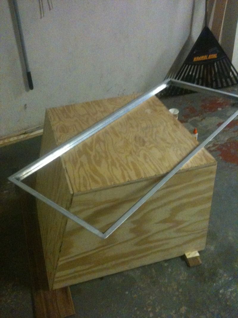

Here is the new doghouse . I will be soaking this up in the old timers recipe shortly .
And the trim ring for my new storage / ski locker .
my buddy did an awesome job , you cant even see any seams on this . He rounded the corners up nicely too .
The plan is to make the lid out of starboard or I may just use a piece of 3/4 ply to match it with the doughouse .

WOW!!! Your friend KNOWS how to weld!!! Dog House looks good! I replied to your PM!!
