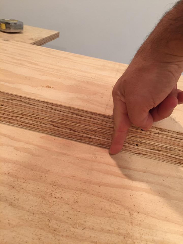

I ended up turning the ply sideways on the table saw and cutting it down to 3/4" thick on all sides. Then I clamped it down and stuck a 12" sawzall blade straight through the center to get where the table saw couldnt reach. Took 3 blades on the sawzall, but I kept it nice and smooth and made a clean cut. Hit it quick with the belt sander and then with the palm sander, then glued them and clamped them. Got my 1 3/4" douglas fir transom board now!!!

You.. you animal! ha ha ha Good job! That'll do it. Seal all edges well, fill any voids and have a great day!
