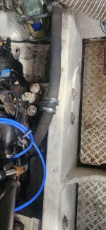

I saw this crack on the main stringer at port engine. It's at the inboard motor mount area. 8.1 motor. This not my boat but a boat we are looking at. Any concerns?

Im not an expert and take this with a grain of salt but that kind of just looks like a superficial crack in the paint or top surface. I don’t think there’s gelcoat there

If you are looking at buying it have it surveyed
That is gel that is cracked. It could be nothing, but it could be wet wood that froze and cracked the fiberglass and gel
