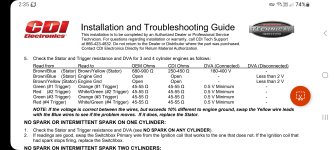

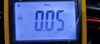

I've gone through the testing and I'm only getting 0.05 volts from the trigger. Is there anything I can do to fix this or do I need a new one?
Nordin
Jun 12, 2010
2,702
Spark at one cylinder but only 0,05V from both triggers?
If you got only 0,05V from both triggers you should not get any spark at all at both cylinders.
0,05V from the faulty cylinders trigger, yes you have a bad trigger there.

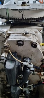

Hence my problem, it can only be connected one way and the flywheel has never been taken off (well not since I've had it). The other photo is where the timing light now shows 30BTDC at WOT instead of the motor mark where it was showing last week which is 180 degrees from spark plug (and have rechecked with a screwdriver). Could the CDi be causing this? I'm trying to make sure I know the exact problem as postage alone from USA will cost me a fortune.

Nordin
Jun 12, 2010
2,702
But if you can not connect the prime side of the ignition coil wrong cause the connectors only goes one way there are ignition coils dedicated for cylinder one and cylinder two.
You are not able to switch the ignition coils.
I believe you can swap the coils, that is what I remember.
But it was more then 6-7 years I worked with this ignition systems for the twin carb 55-65Hp Chryslers soo I do not remember exactly.
If the top cylinder spark at 180 dgr at idle the bottom would spark at 0 dgr.
Is the bottom sparking at 0 drg?
Swap the HT wires ????
If the top now sparking at 180 dgr you would not be able to start the engine.
Check the wiring with the diagram for 82-85 55Hp Chrysler which you can see at Mastertech marines web site.
