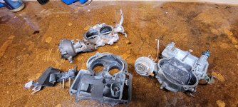

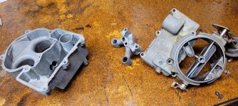

I ended up using white vinegar and only let it soak for 15 minutes. I scrubbed with a toothbrush, rinsed thourghly dried with compressed air.
I previously tried Grez-off, letting it soak for days, but it really didn't do what I had hoped. We use it at work as a parts cleaner(environmentally safe).
I'm very happy with the results and will rebuild it..🤞

I used a ultrasonic cleaner and they work great plus you can clean almost anything in them well worth owning one.
But looks like you got carb. pretty clean hope it works out for you.
88 Capri (2022 SOTY)
Master Chief Petty Officer
Aug 25, 2019
864
I agree that those ultrasonic cleaners are great!
All of the orifices are clear, and the pump walls are nice and smooth. If it works I have a good spare, and if not, it was a fun little project. 😉

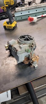

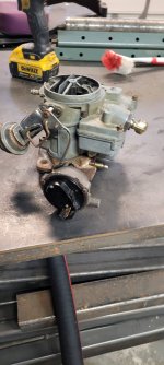

Well, she's rebuilt, and I'm happy with the results. I'll give it some paint when it warms up.
