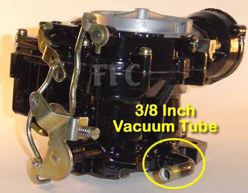

A few weeks ago I bought a new carb to replace the POS that had been acting up. Boat is a 1977 tiara w/ mercruiser 898 (chevy 305) and alpha 1 outdrive. It turns out the original is a rochester 2 barrel and I bought a mercarb instead because i'm an idiot. I obviously thought I ordered the right one, but I did not. It looks exactly same and the boat runs but I've been having some problems recently but I'm not sure if this the cause as many other parts have been replaced and fixed.
This is the carb that I received in the picture. It has the vacuum tube. The Rochestor did not. It came with a small rubber cap on it, but I think this is what's causing the problem.
The problem is rough idle and then sometimes it backfires once warm, especially with a heavy load going into waves. The only thing I can think of is this vaccuum tube or a bad gasket that is causing an air leak. I've taken it into a reputable marina/mechanic and they fixed the exhaust bellows, they said the last place used the wrong adhesive. Can I just plug this vaccuum tube or do I need to go back to the rochestor?

The tube is for a pcv system, you can plug it or add a pcv set up, my personal prefrence would be to add the pcv, better for the motor and the enviornment.

Its nice to have a vacuum port so you can dial in the idle mixture. Hook a vacuum gauge to it to see what the motor is doing. Just a thought...

The hissing is probably the carb itself and the engine... that's normal. As far as rough running... prolly just the mixture screw needs adjusted. Make sure its about 1 and 1/2 turns out from seated. This will get you in the ballpark. If you hook a vacuum gauge to that port that's capped you can dial in the mixture perfect.

What engine was this Mercarb for? If it wasn't for an older 305, then jetting and adjustments could be off. I suspect that it is for a newer vortec, which has pvc system.

The carb has been a problem for as long as I could remember, which is why I decided to buy a new one. It had similar problems of a rough idle and would sometimes act up not letting you get up on plane, sometimes it worked just fine. I went over and took a look at the mixture screw. I saw how many turns it took to seat and it was roughly 3 and 1/2 turns. I have a feeling this is the culprit, and its a game of getting it set right. I also took off the rubber cap on the pcv valve connection and when I do that it won't idle at all.
I guess tomorrow I'll haul it over to the lake with some tools and see if I can get it adjusted properly. I think I also need to make sure the cap on the vacuum tube is sealed tight, any ideas? Is a vacuum gauge the best way to tune this? If so how would I go about doing that?

The default starting point according to the SM, is 1 1/4 turns out. On any new carb, you need to do idle mixture, idle speed and choke adjustments. Keep that vacuum port sealed or a vacuum gauge on it. It will be way too lean with that open. The merc procedure doesn't use a vacuum gauge, but I always hook one up to my engine while doing any tune-up/adjustments. You can do a more precise mixture adjustment, but the bigger value is in additional diagnostics on your engine.
