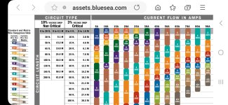

Here is an ampacity chart. You want your fuse to blow before exceeding the ampacity of the wire if it's dead shorted. Then from there you step down again to protect the device from burning. If you have a 10 amp device you run a wire to carry 15 amps and fuse at 10 amps for the device. If your existing wire can only carry 5 amps your device must be less and your fuse shall not exceed 5 amps.
