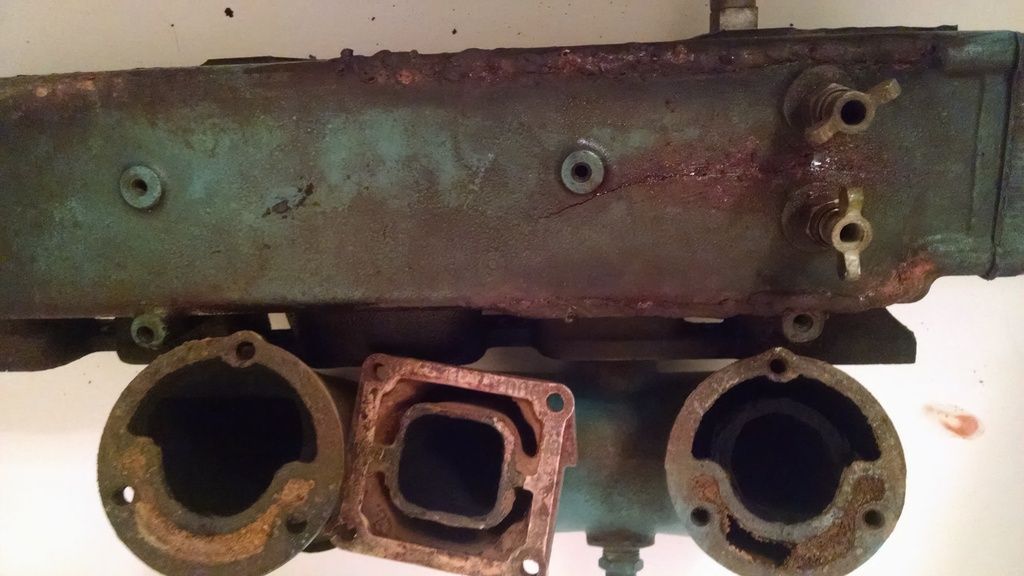

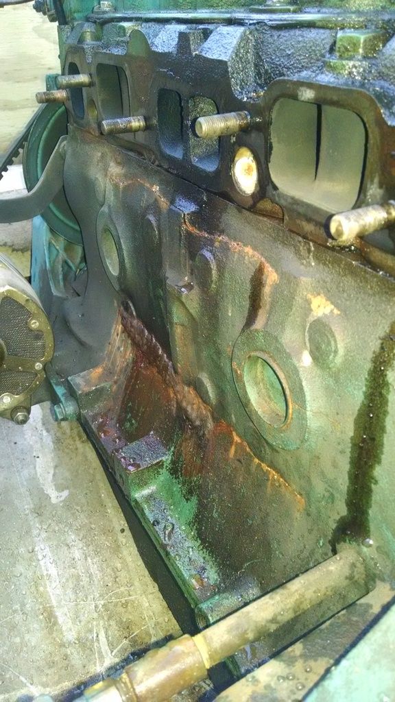

Ok, first a little background. I have a '78 Harris Flote Boat with a '77 OMC 120 Sterndrive (model #990234E). I got the boat for cheap cheap last year and have only had it out a couple of times. Long story short, the block has 2 cracks, one has been previously welded, the other has not. There is water coming from the one that has not been welded (but no water in the oil). The manifold also has had a crack welded, and is full of rust. Compression test showed ~65psi across all cylinders. I did manage to have the engine running last week before I discovered the cracks, but it only was only running on 2 cylinders. Basically, this engine is toast.
