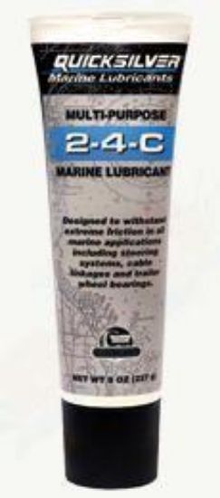

I've got good visibility to timing marks from both the drive shaft side and the stern end. I think it will work without removing fork. Does 2-4-C replace special lubricant 101?
Seems you may be good if you're able to align with the marks on the housing... I believe it was 2006 is when they went with smaller, hard to see lines.
Yes 2-4-C is/was able to be used in place of 101 should it had been needed in the early years too.
Quicksilver 2‑4‑C Marine Grease with PTFE is a high quality, extremely versatile lithium‑based, NLGI 2 grease that won’t break down when mixed with water. It also has:
• Excellent resistance to oxidation and degradation
• Extreme pressure additives to withstand friction in a wide variety of
operations and temperatures
Replaces Quicksilver Special 101 Lubricant part number 92‑802865Q02
For use in the following marine applications:
• Steering systems/cable linkages
• Throttle and shift cables and linkages
• Remote controls
• Prop shafts
• Swivel pins
• Tilt lock mechanisms/tilt tube
• Hinge pins
• Boat trailer wheel bearings
