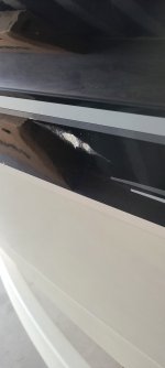

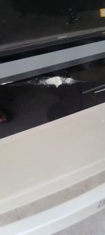

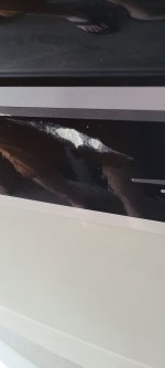

Ran into the ramp (not in the best shape) when a gust of wind picked up and i hit pretty hard. What is the best way to patch/seal this? Is their colored type fillers? Thanks for any input!! 2004 Sea Ray 185 Sport

Contact Sea Ray, get the Gel Cote number from them. Then contact Spectrum, a sponsor of our forum, and they will get you the correct mix, tho it may vary because of sun fading after 18 yrs.
JASinIL2006
Feb 10, 2012
5,760
Second option is to buy a gel coat repair kit (see below) and match the color as best you can. No matter what you do, you'll need to fiddle a bit because, as @zool noted, your color will have faded from what it was originally.
I've used the Evercoat kit and it's not hard to get very close to the current color.
