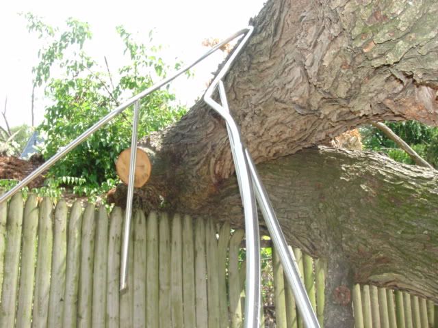

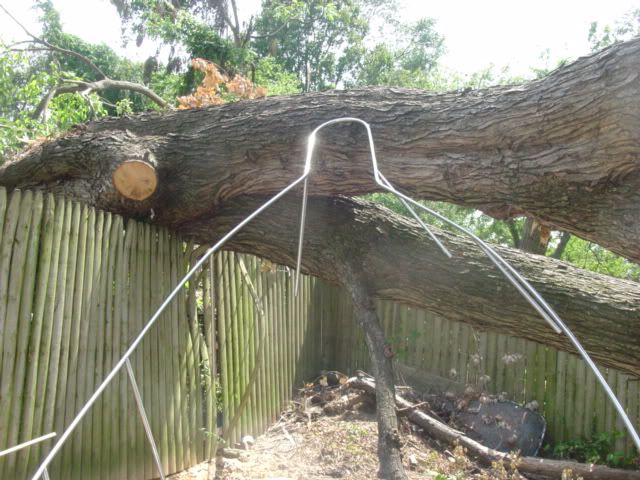

A huge tree fell on my shed and demolished it - my bowrail got a glancing blow, and it was bent - no kinks. Can it be repaired? :facepalm:

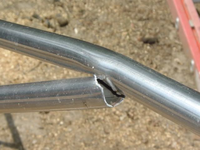

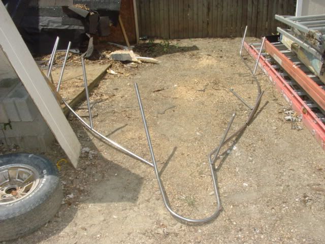

Pics:
The insurance gave me the limit of $1,500.00, for the rail :) I got an estimate to replace it for $2,500.00 :redface: It would be great if it could be fixed ?

A good metal fabrication shop with someone that knows how to weld stainless should be able to fix that for less than $1500. Make sure they Know how. Here's a primer on how it's done so you'll now what to ask...
Welding Stainless Steel
Feb 17, 2012
2,906
Re: Bent SS Bowrail
thats a simple fix with a tig welder then using a acid cleaner to remove the color of the weld. if the broken leg pulled a hole in the rail tube then purge the inside of the rail with argon while welding it and that will allow a hotter cleaner weld. the bent piece can be nudged back with a hand pipe bender used for conduit. a shop might be able to copy that one in new material for 1500 as they can use that one to set up a jig which is the expensive part of making one.
$1500 for a couple inches of welding and some straightening? Yikes! Looks like a job that should cost no more than $100 bucks tops.
OCD meds are cheaper than spending a fortune to make it 'perfect' again. ;):D

Should be a walk in the park for a good welder.
We had a guy here that could fix this right on the boat.. no jigs or nothing..bam done in hours.
600-800 bucks would be what we got charged.
YD.
Thanks Woodonglass
I'll definately hold on to it, and see. The fabricator I spoke with today said he doesn't have the jig for the horeseshoe bend on the front thats $500.00.
