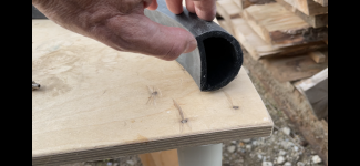

I am working on a 15 square meter solar cell driven Catamaran and are now about to assemble the 2 pontoons to the bottom plate that are connecting the two pontoons.
The bottom plate is a 40 mm thick sandwich construction with XPS foam in the middle and 1.4 mm glassfiber on each side of the XPS foam.
I am doing all the work myself and it went quite well - untill today.
Now I desperately need the help from your community.
I made a test where I glued a 50 mm high D-shaped fender list on a 40 mm test glassfiber mock up, with Sika 591, at let it dry for 1 week - See screencapture from 3D model below.
It was highly recommended in several forums for gluing rubber on glassfiber, so I expected, that my small test would show, that everything would work perfect.
BIG BUMMER!!!
The Sika 591 stuck perfectly to the glassfiber, but I could peel off the rubber from the Sika 591 with only a force of about 200 grams!!
The rubber is something, that is a little "foamy" with a thicness of about 6mm and because it has been rolled up for many years, she straight part of the D profile is convex with about 5 mm as well - meaning, it is impossible to press the D-profile in against the side of the bottomplate.
So there is many issues here,
I COULD plug the ends of the D-profile and fill it with a little air while it is glued in place in order to make the D-profile straight again.
Questions:
1. What would you do in my situation?
2. Can you recommend a glue, that can stick on rubber and work for at least 25 years? some 3M product
3. I work with epoxy for all the glassfiber work I do on the boat. Is the solution as simple as using wpoxy and filler?
4. Do you recommend using the tedious and annoying work to place a LOT of threaded nuts and attach the fender list with bolts?
In the hope to get to learn from your experience,
Christian

On my way. I have cut of a sample and will try to pump the profile up in the hope, that it will staighten up after many years on storage as a coil. Then I can better sand it and perform several glue tests at once. Now waiting for the epoxy to dry.

Nothing to lose.
But if its been coiled up that long, chances are good it has a "memory" which you're not going to totally remove without some extreme measures.
