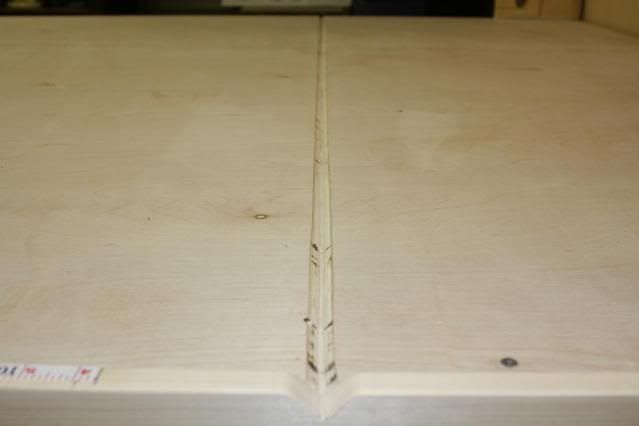

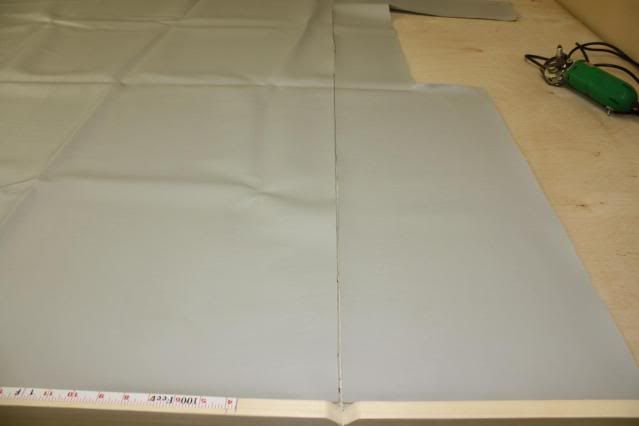

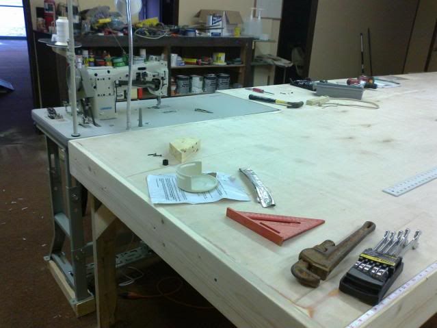

trimmed out the table....just for looks, and sanded it smooth so vinyl will slide easily

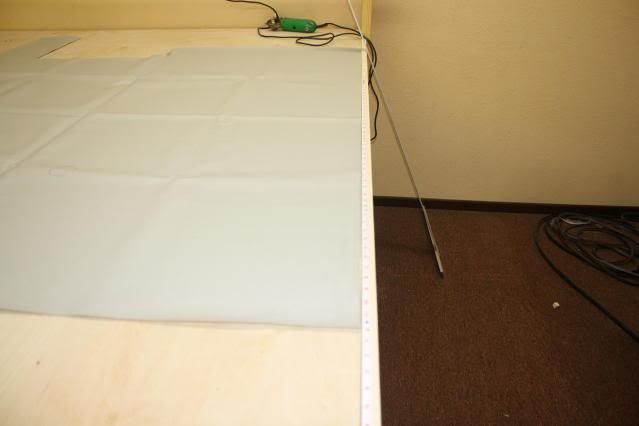

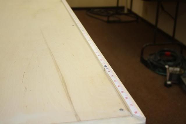

this side of table I left trim 1/4" higher than table to use as a straight edge guide, and added a measuring tape to the top
Having the straight edge ensures a square straight cut using my electric rotary cutter in the V groove, makes the cuts very fast
I am trying to think of something I can put in this groove...like a light metal angle, to keep the cutter from wearing down the groove with sliding it across... any suggestions?

Aluminum drywall corner maybe? If not that, then a "corner protector" for inside walls. Usually made of vinyl or plastic or plexi?

Maybe if the groove is a perfect 90 deg you could find a piece of allum angle to glue in or U channel.. I know what would be perfect . At work we install allum fry riglet trim that comes in all sizes and width's It has a flat screw flange on each side to receive joint compound.
If you just were closer I could dig some out of the shop. If there are any drywall businesses or supply places near bye they may have some in stock.

it is 90 degree...those might just work...thanks for the ideas!

Don't they make self-stick teflon glide tape? It may already be creased down the middle... Woodworking supply store....

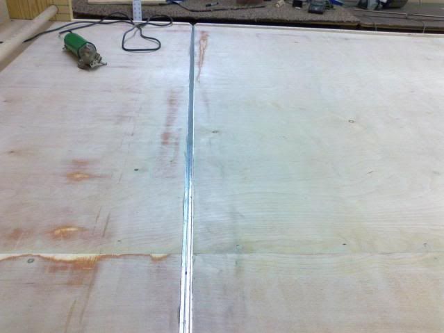

As far as my channel goes, I decided to stop by a few machine shops and I finally went to an HVAC guy and had a piece of galvanized metal bent for the groove....should last a lot longer than bare wood.

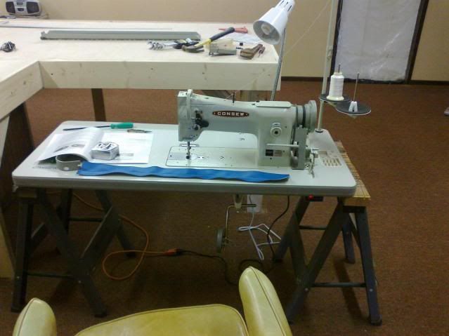

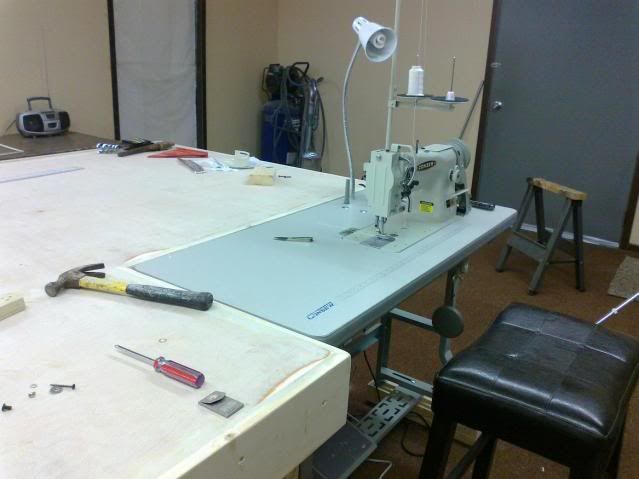

I got my machine, but have not received the legs for table yet...So I used some saw horses to get the table set up, once legs arrive it will be easy to put it on

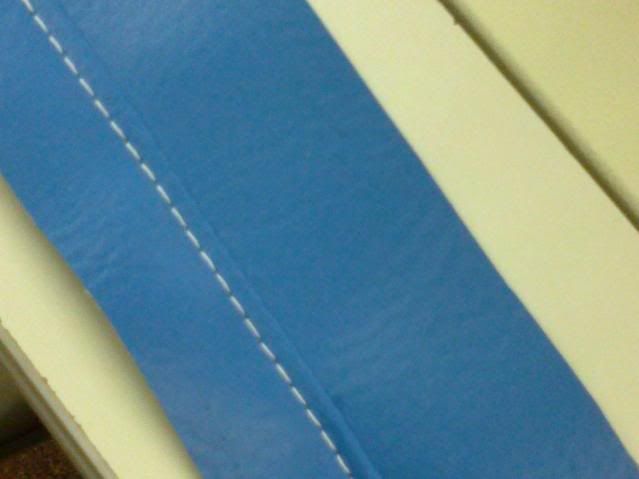

Impatient as I was to try it out, I ran this piece through the machine....mind you I did this one handed because my other hand was reaching under table to activate motor, so it wasn't perfectly straight. Lays a really nice uniform top stitch though
Will throw up a pic when table is built and inserted into the big table

Thanks, I just hope the time and money spent on this table improves efficiency....my theory is sound, now to see if it works in practice!

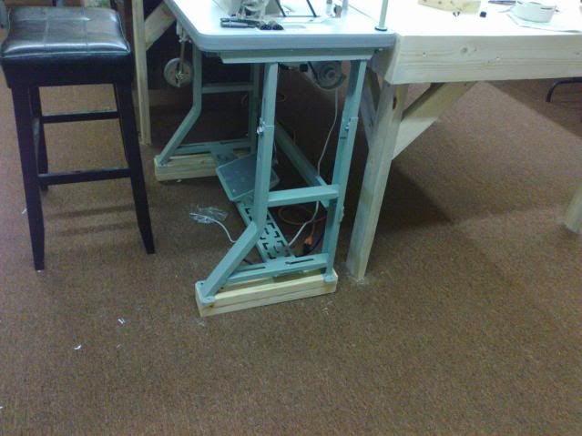

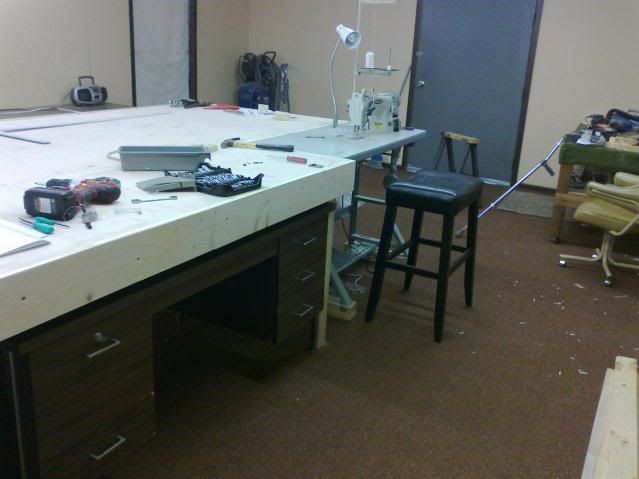

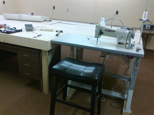

Got table finished, pretty happy with it overall...only thing that bugs me is the vendor told me table dimensions were 24X48 and it was only 21.5X48 so my cut-out was wrong!
Threw an old desk under the table to give me some drawer space....it was quick and free so I cant complain
Put 2 2X4's under the legs to get it to match table height, the sewing table would not adjust past 33"
came out pretty level
I just love when a plan comes together....now I have to take it apart so I can get rid of that 3" discrepancy! Just kidding, I will learn to live with it

Looks like your getting things set up for some mass production..
BTW , good idea on the hvac shop bending the metal . I didn't think of that..

Wow! that set up looks first class...Awesome job!
As for the minor discrepancy, just build in a small filler piece between the machine table and the run out table...

Here is how the piece of galvanized metal the HVAC guy bent me worked out....tool glides a lot smoother and should hold up much better than bare wood

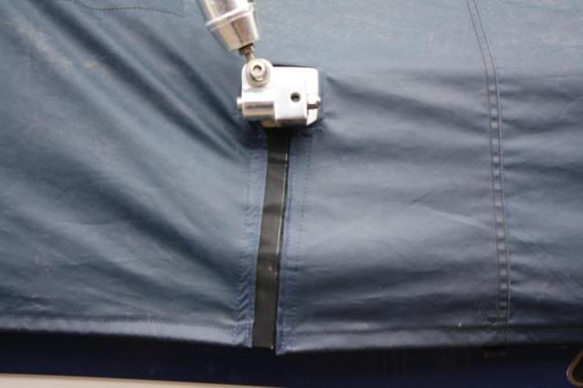

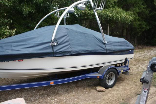

Got to put my machine to work, this guy put a new wake tower on and wanted his cover modified to work with tower, so I cut slots, and added a square cut-out around wake tower mounts, then added velcro to the slit so so it can be closed

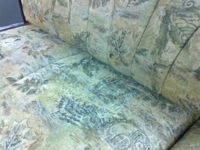

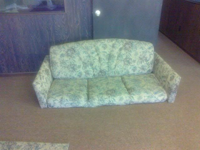

So I will probably get booed off the forum for this! but I left my cozy little comfort zone of plywood, vinyl and staples...and went in the evil world of cloth, metal frames and hog rings.....
An RV scissor couch (folds into a bed)
Before, badly in need of recovring

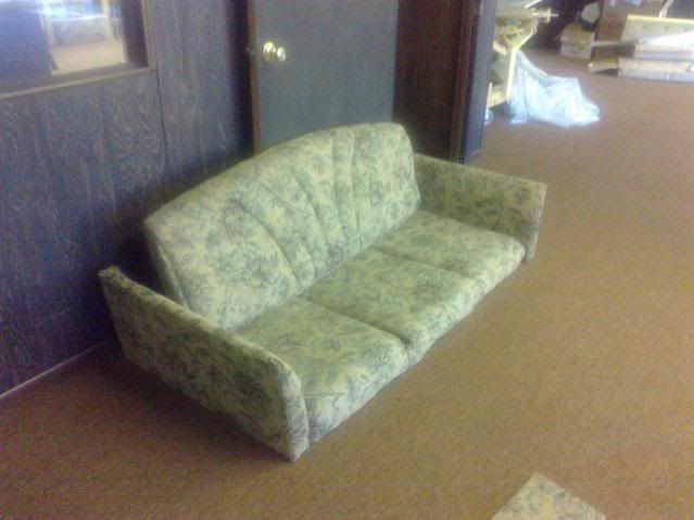

Could not find an exact match of fabric, but this one had all the right colors and floral so should blend well with RV interior

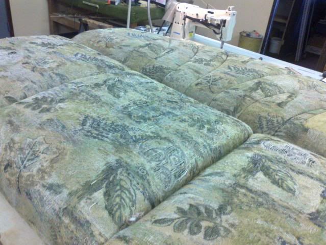

Recovered, but not pulled tight...the frames are drying, had to remove rust and repaint them....Really pleased with how my pleats came out...the new machine is AWESOME
All the pieces recovered
I know its not boat, but the concepts are the same and can be used for vinyl... and that's what I would like this thread to be about so people wanting to reupholster their own boats can get some ideas
