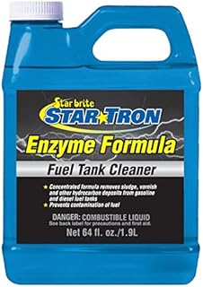

You can try this stuff too...
For what its worth..in a side by side test (mentioned in my other post) I did between Sea Foam and that Startron, the Sea Foam started melting the sludge in about 30 minutes to total liquid overnight. The Startron showed no change after sitting much longer...if memory is right I let it sit for 2 weeks and it did nothing to break down the sludge. That was maybe 10 yrs ago so they may have changed the formula by now but Sea Foam blew Startron out of my shop forever.
