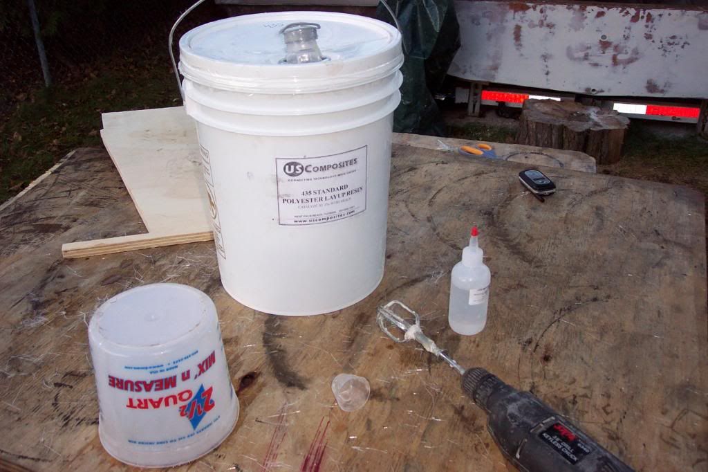

I picked up a small container of 405 west system filler. Will it work with Polyester resin?

What's the ingredients? Typically it's an epoxy filler.

That's kinda what I thought. Cellulose and walnut flour will make it susceptible to water penetration when used with Poly. Not so with epoxy. Not saying you can't use it, just that using it just like Bondo uses Talc, makes it not as waterproof as if you used cabosil.

Thanks again Wood! I'm not going to mess around with it then. I will use the glass bubbles I have until I get more cabosil.

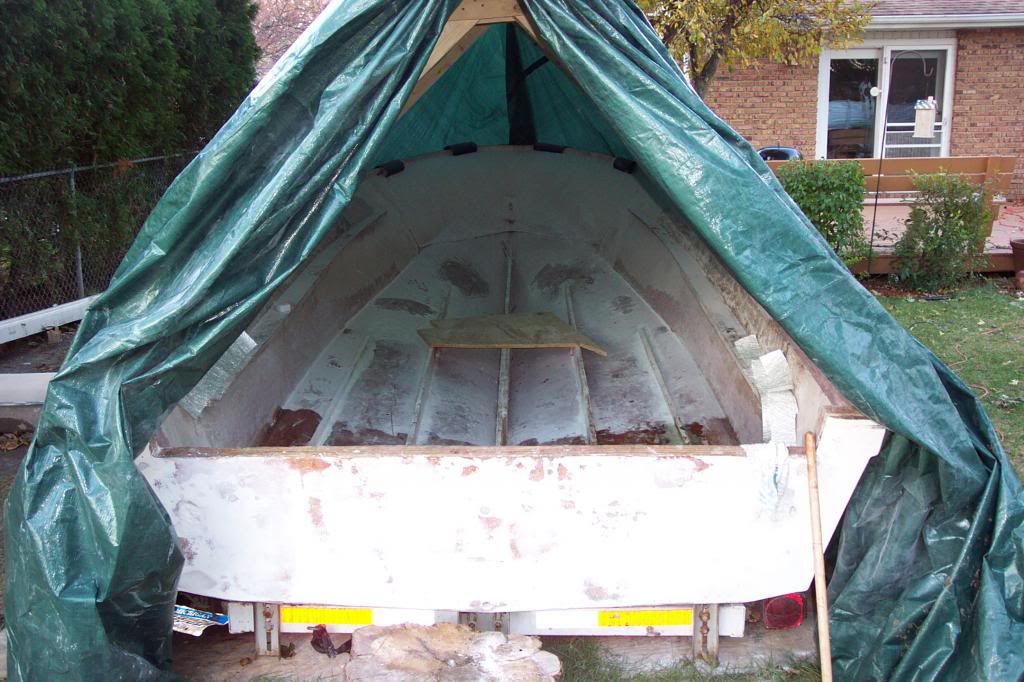

Glad to get something done today. All the wind and rain has made it difficult lately. Started tabbing in the stringers.

Making quick work of this project!
Looking good....

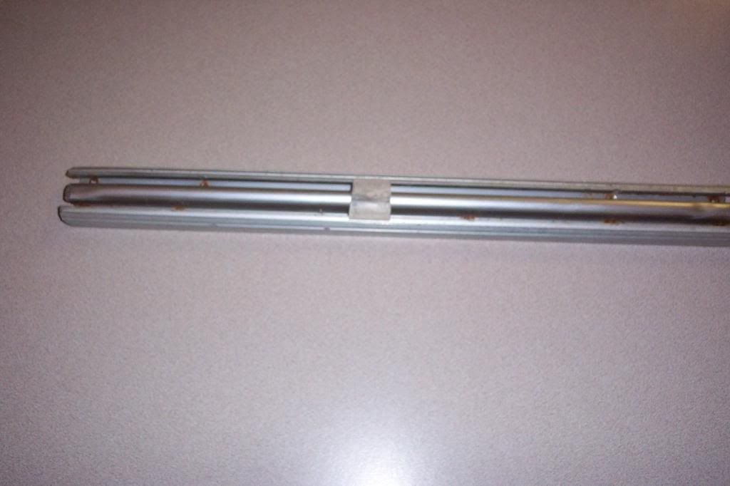

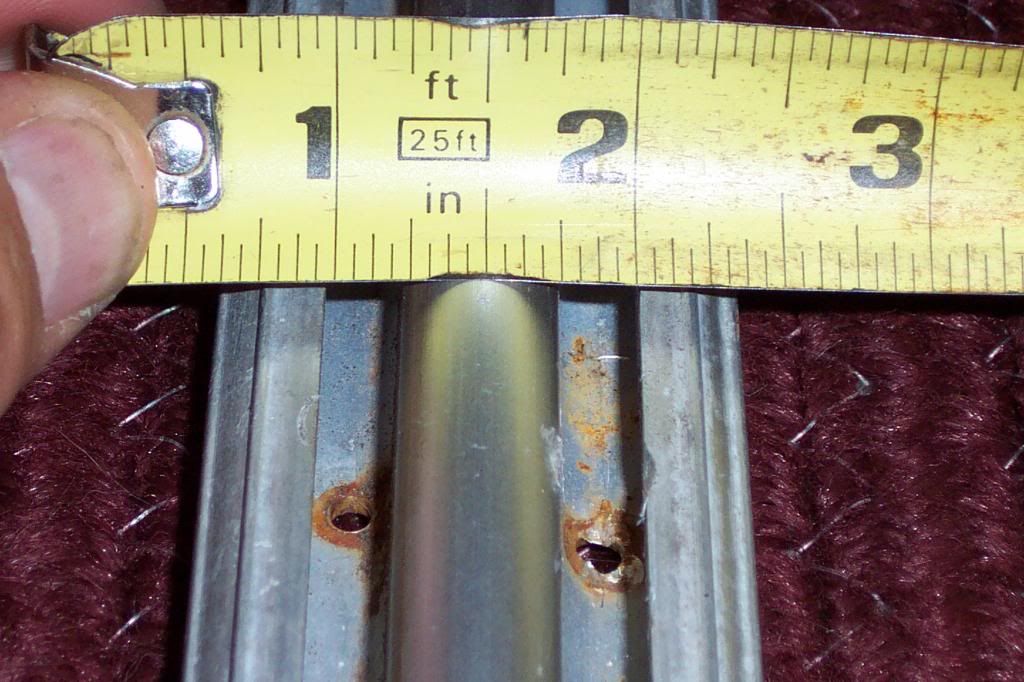

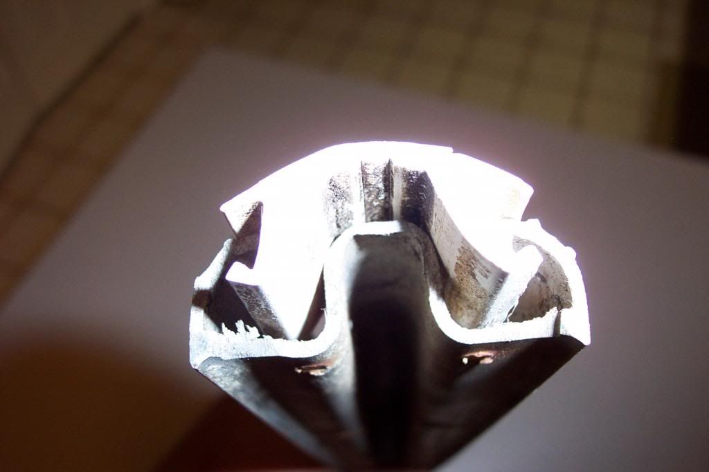

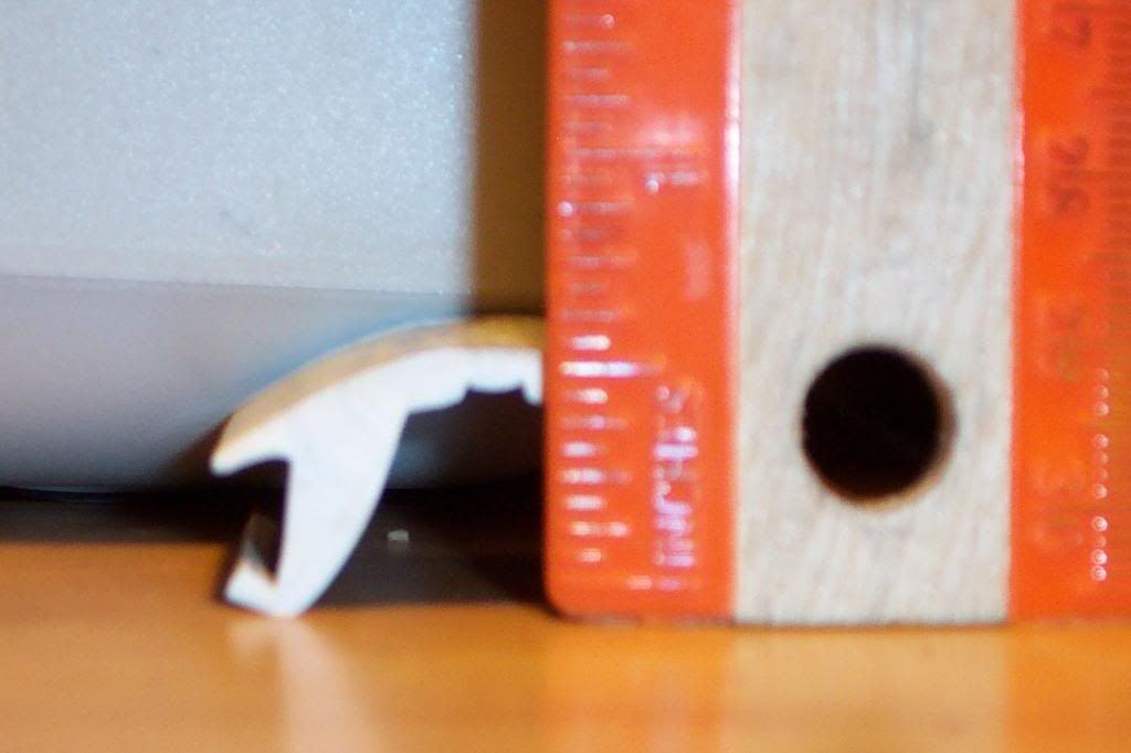

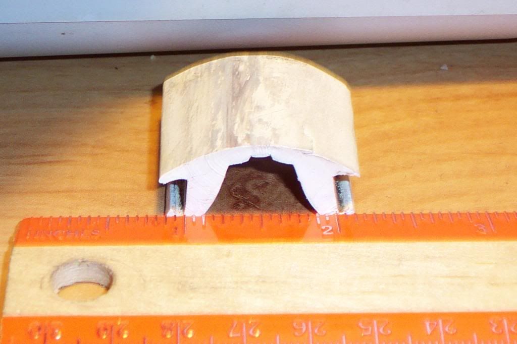

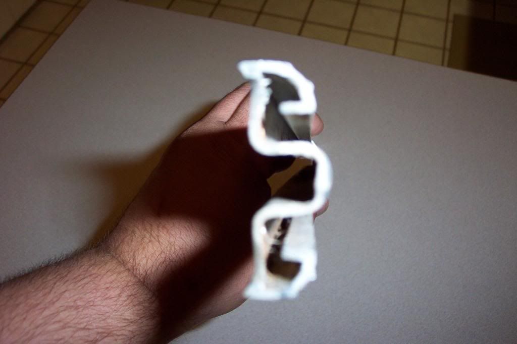

Need help locating a rub rail for the Aerocraft. I have looked at Taco and few others online without luck. Either just the rubber insert or a completely different setup, any ideas?

Are you wanting the Aluminum Rail, the Rubber insert or Both?

I want the rubber insert. Thanks Wood!

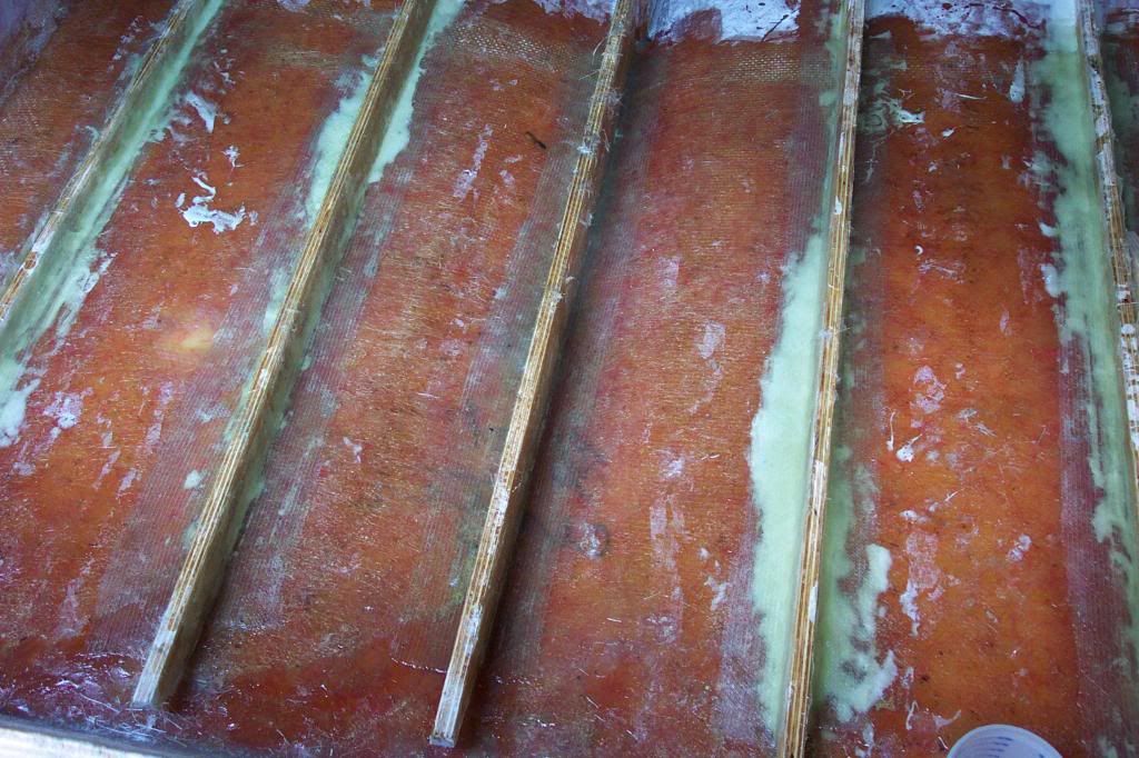

Ok had a good ruff and scuff event last night. felt good still need to final vacuum.
Thursday I was able to get the first layer of 1708 down on the 5 strings up about the first 4 feet. The peanut butter made with glass bubbles and chopped stran looks carpy I should of cleaned it up better.
