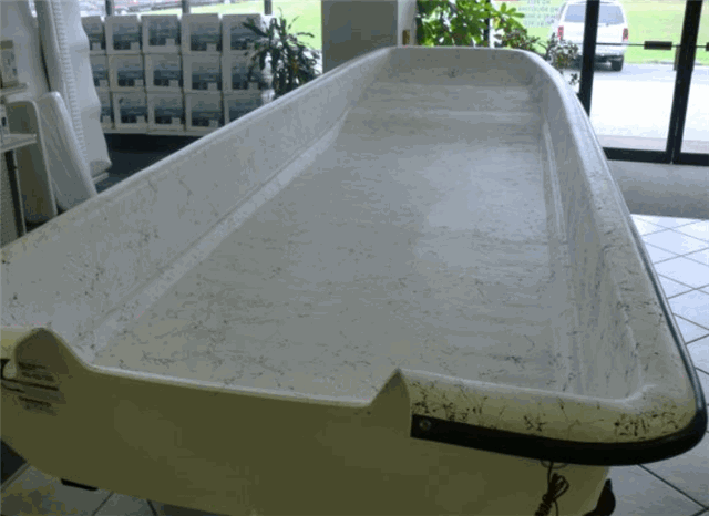

Thanks for that advice. Here is what I am doing.
I will have a hull like this one that everyone says don't screw into:
I want to add mounting blocks for things to the floor and walls. As you all have suggested I should use some sort of stable wood. As you can probably tell, I don't know much about working with fiberglass. So as I understand it I would buy some products, epoxies? or whatever and glom it under and over these wood blocks?
