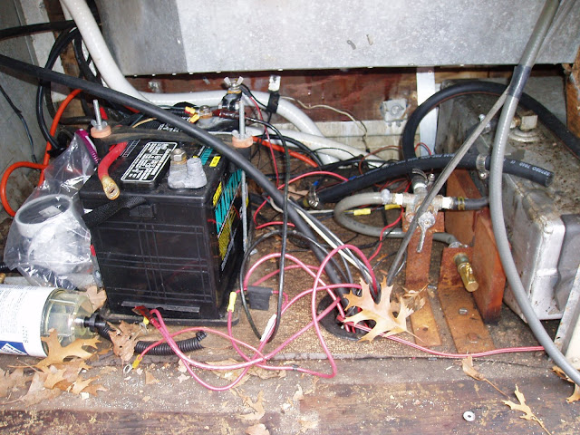

Hey Matthew, Nice project. Browsing the photos I came across this one, kind of reminds me of those "I Spy" photos where you try to find the listed objects hidden in a mess of stuff.
I spy a 3 way valve, some 10 ga wire, a male portable tank connection, a Moeller water separating filter assembly, a spare filter cartridge, various hoses and cables....
Lots of good stuff in there! Don't toss it!

Yeah, there are some goodies. I bought the filter last year - it's a Racor. The three way valve may or may not be used, depending on what my fuel tank situation winds up being - a new tank is in order, and it's not going in the splashwell. I figure moving some weight forward in the boat will help the ride. I put two new bilge pumps in last year: 500 gph main pump and 1500 gph (mounted higher up than the 500) for emergencies both on three-way switches- that's what white hoses are - those are going to stay, obviously. I'm very glad to be getting rid of that birds nest and junkyard under the splashwell. I'm starting from scratch with the wiring. Since I decided to run the boat last season, I did the best I could to make it serviceable.

if you look closely you can even see a perfectly good looking battery in there!

Hey Lego, you're right! Took me a few minutes, but I found it. Man, that was even harder than those Waldo books. :D
