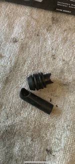

Unfortunately, upon reinstallation I moved something just right enough it snapped the plastic fuel fitting to the inlet of the engine that feeds the carbs. With having the Vro bypassed and a aftermarket fuel pump. this fitting is a 90 degree elbow with two rubber o-rings and the other end smooth for a fuel line. Cant seem to find just this fitting anywhere. i see the versions for the VRO pump which would bolt to the top of the pump. and press into the motor.

Here are some images of the fitting. the image of it together was a failed attempt at plastic welding it. unfortunately the plastic supplied with the welder is not fuel rated and did not hold up, so came back apart. The image of the fuel pump has a metal version of the same fitting.

As for the fuel fitting, do you happen to know where I can find a replacement? I’ve had no luck, only finding the version for the vro.

As for the fuel fitting...
You must always pre lube with oil or grease any plastic or bakelite fitting before inserting it into any rubber hose, seen many broken fittings due to too much force applied when inserting the fitting into a dry hose...

Replaced fuel fitting.
