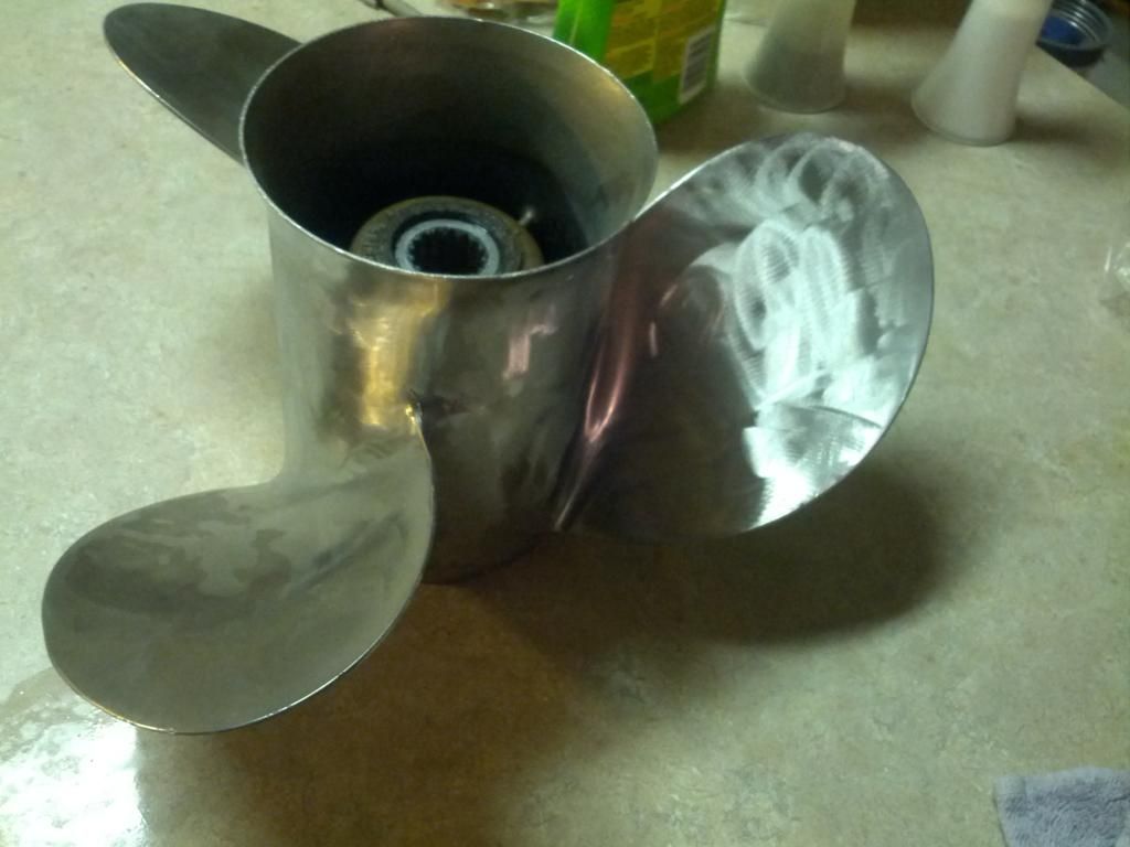

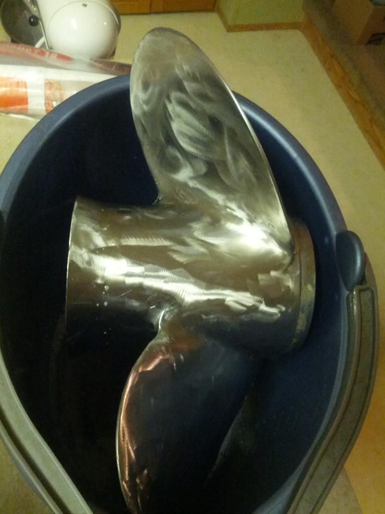

Check out this hog. I didn't touch it with anything other that soaking it in some commercial lime and calcium cleaner...it dissolved the scale right off it. Noticed all the sanding marks.
MikDee
Banned
Jun 6, 2007
4,745
I don't think polishing it is gonna help much? It is a generic "elephant ear" design. More for power, then speed. The trick with SS props is their strong thin blades, that don't flex much compared to aluminum. Their rigid design, gives you the most grip on the water at all times.
By the way can you see my prop pix? I can, but I never know if it's gonna appear here for others to see?

Yup I can see them. I have a merc black max 19p ready to buy. But it looks like the same blade design to me. Maybe they use some generic stock picture.

I just know you'll probably see a rise in rpm's just by going to an Alum prop. ;)
You have that backwards. A SS prop will always have higher RPMS given prop pitch and propeller shape is identical. Reason for this is the SS will have thinner blades with less drag.
The problem of course is one brand or model prop to the next will likely have a completely different shape and cup even with identical pitch.

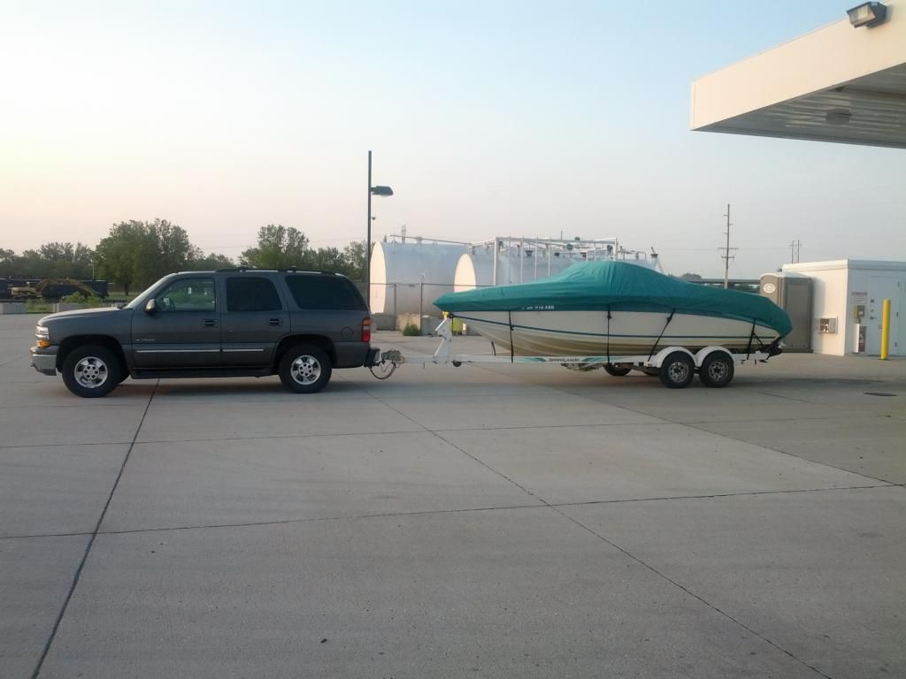

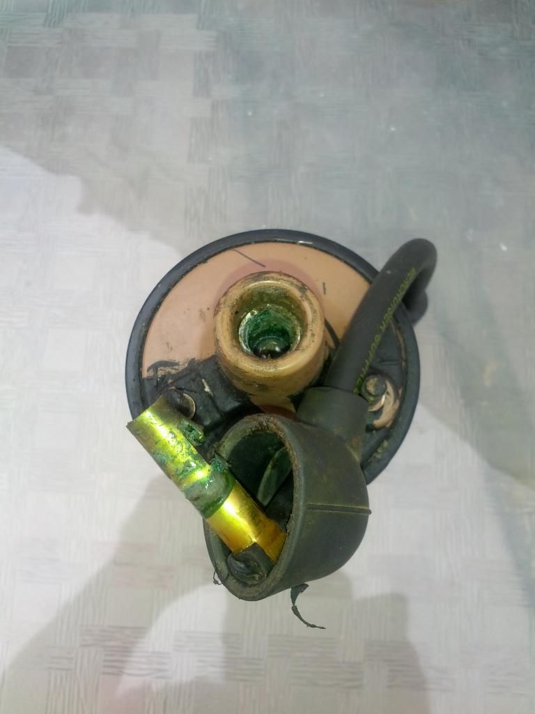

UPDATE: I ordered a new coil as the one on the boat looked original while most other items were obviously replaced recently. Here is a picture of the old coil, nasty. Also had to buy a larger vehicle as the blazer was not gonna cut it to pull this hog down the highway. It did it, but struggled. Found this one owner 2002 Tahoe that's in excellent shape with a towing package. It works great pulling this boat. ALSO... there is my westlands exact fit sunbrella cover. Very impressed with it so far. Its the perfect length, could have been a little wider in some spots. Also some reinforcements could have been added in spots, but overall its a great cover with nice straps and it trailers excellently!!
With the new coil installed, the boat felt like it ran better and harder. On some good chop I was able to trim it to about 4,400rpms and get 48mph. But I also verified that this carb is trashed. There is massive vacuum leaks around the throttle shafts and im constantly adjusting the idle. Got a reman unit ordered on ebay and it will be here this week. I don't know if its a placebo or not, but it felt like there was less drag on the boat with that prop being cleaned and smooth now. IDK.

Glad to hear from you V.C. It all sounds good! Not a placebo effect, anything you can do to make the boat more efficient is gonna help. That coil looked toasted. Love the boat, and cover in Teal, and the Tahoe especially in gunmetal. Boy I wish I was you! ;) Please post back when you get your carb issues sorted out. Have you tried any Mobil 1 synthetic oil yet? later, Mike
