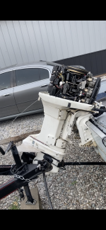

Here is a photo of the engine
39,852
Does the tell tale hose fitting come off the side of the block , yes or no ?-----Note----I know what a 3 cylinder 60 looks like.
39,852
There was a service bulletin in 1994 to move tell tale fitting from the side of the block to the top of the block.-----I would be taking the head off to look at cylinder walls.----At 85 PSI there might be serious issues.
