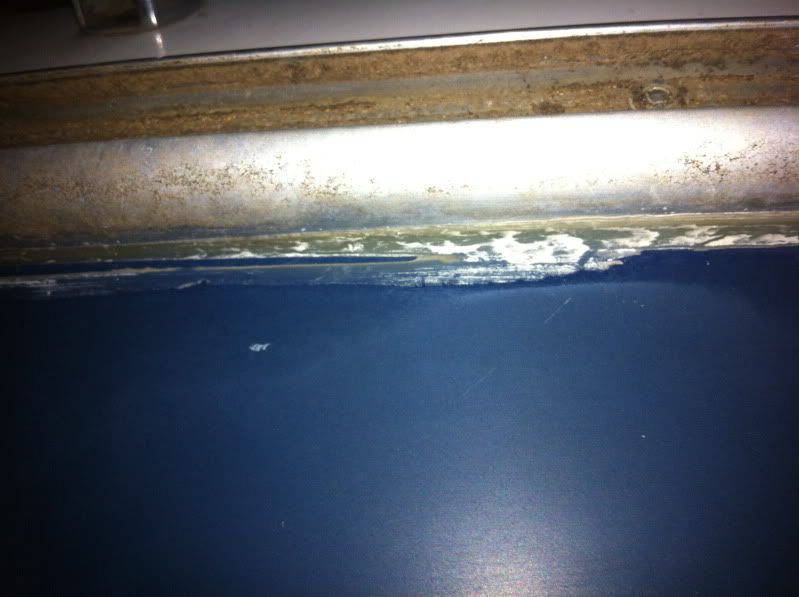

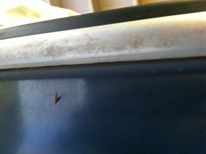

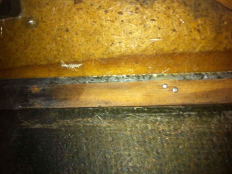

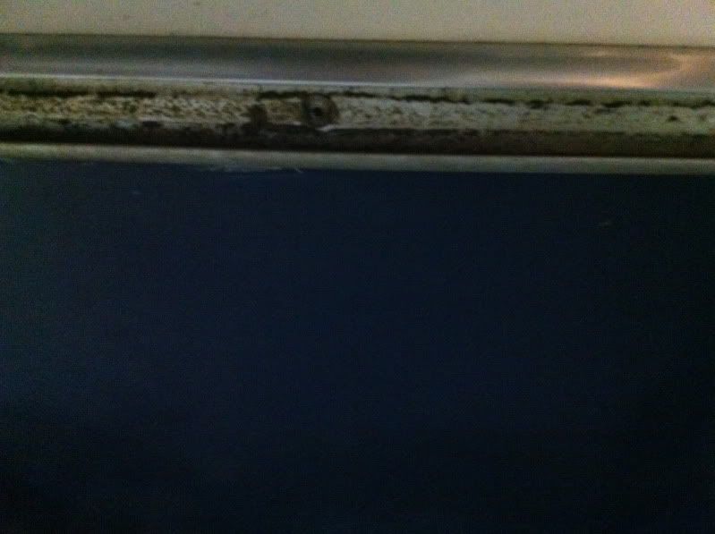

So I started looking at taking the top cap off because I can see the wood is rotted up towards the bow under the floor that is part of the top cap. It looks like the top cap lays over the hull, I think the pictures will make more sense. The rub rail is mounted with rivets, can I replace these with screws?
My other ideas were to cut out the floor that was part of the top cap, just the floor part though.
Or..... I could cut it out like Mroz's Invader bow rider

I'll take some better pictures so you can see why I'm pretty sure there is wood up there, not to mention the stringers run all the way up there and I'm 98% sure mine are completely rotted out. I'll also take some pictures so you can see the "storage" area that was created before I removed some of the panels.

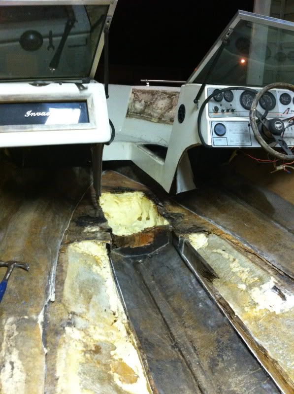

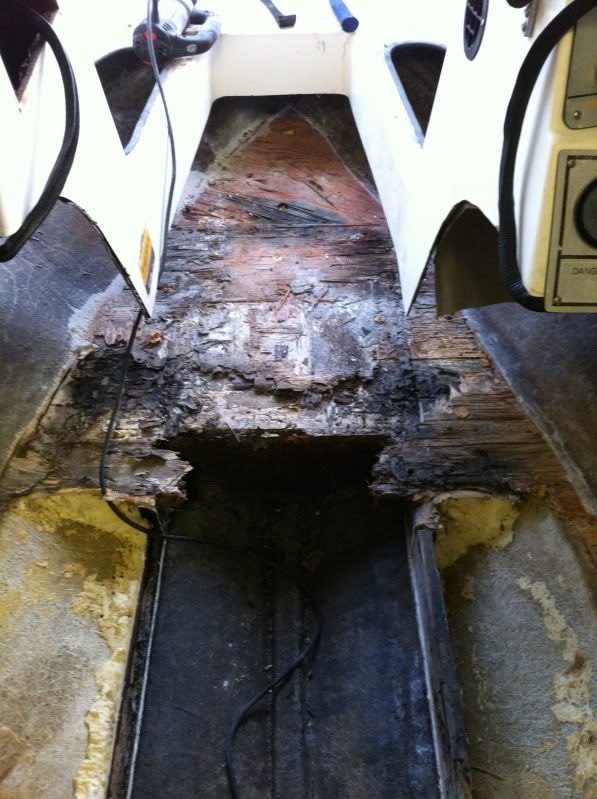

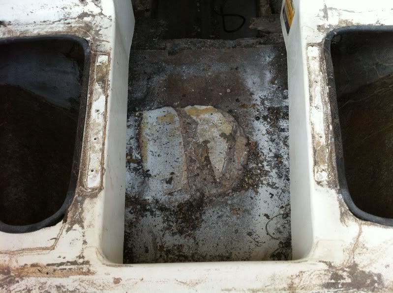

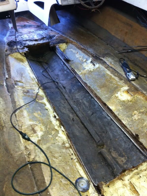

So I've been busy the past few days! Take a look below :D
Nice and dirty in the bow, I new there was junk behind/under the top cap
Got some more of the foam cleared out.

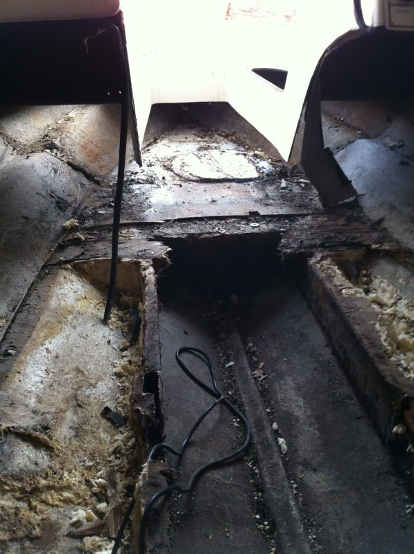

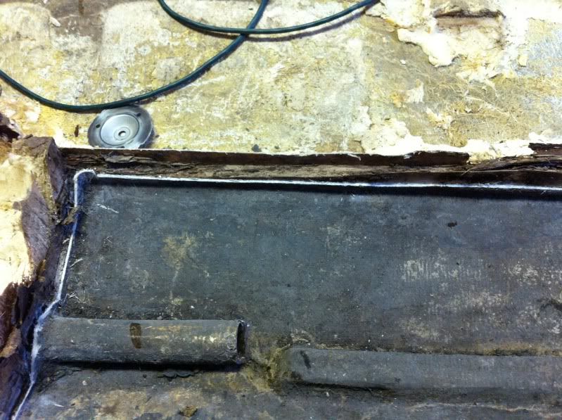

Re: 87 Invader v171

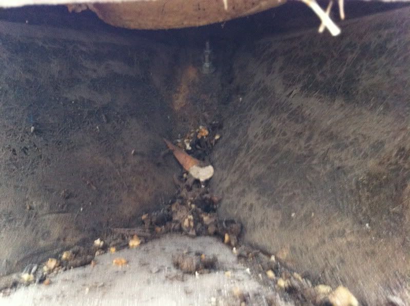

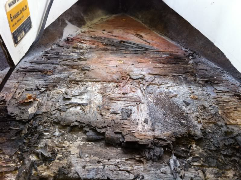

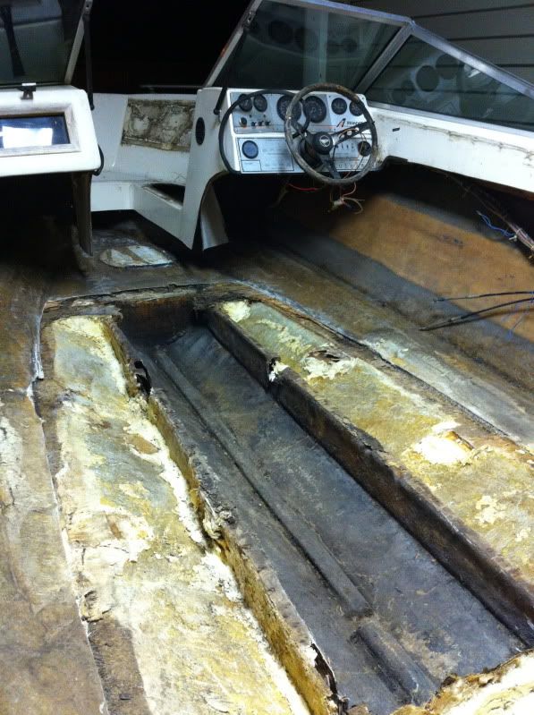

Cleared out the fiberglass from the bow, just as I thought rotted wood :(
Cut out the rotted portion of the stringers and most of the fiberglass casing around them.

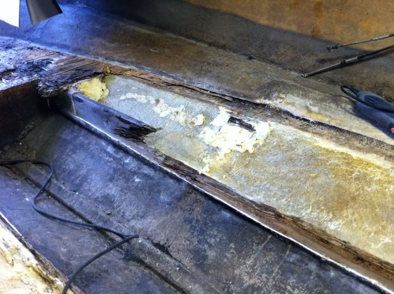

One was reallllllly rotted
The other one wasn't as bad, but definitely needs to be replaced

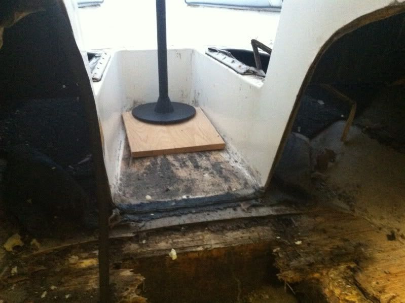

Re: 87 Invader v171
Started pulling out the wood in the bow and clearing out the foam underneath.
As much of an annoyance as the fiberglass cutting has been, I find the foam is the biggest hassle of the destruction, other than the 90+ degree weather we have had the last week.
