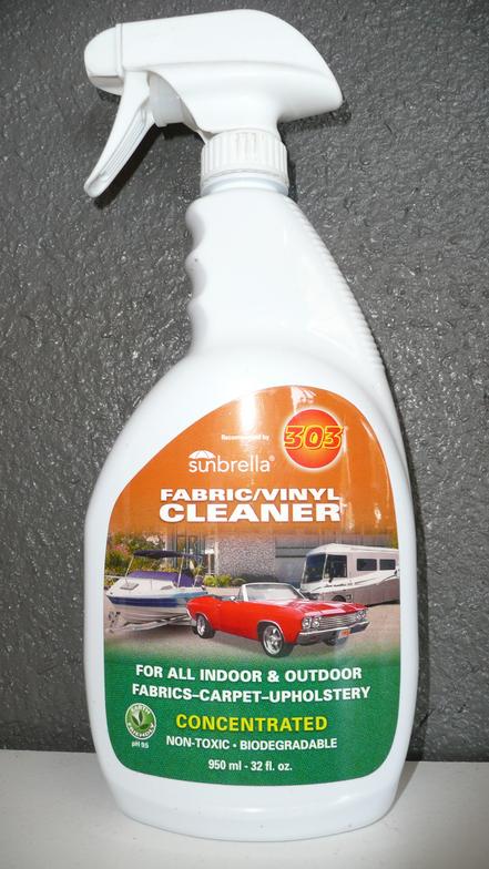

Speaking from experience, this stuff REALLY WORKS great on cleaning vinyl.
303 Vinyl Cleaner. A Bit Pricey but...Worth it cuz it WORKS!!!! It'll makes those chairs look NEW!!!!
