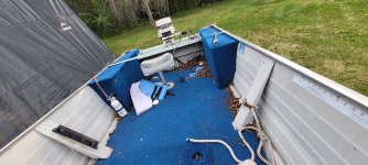

Hi. I'm replacing the floor on my boat, 1985 Crestliner Nordic. Rotted out. Can step right through if I tried. Was just going to do the one spot, but didn't think I'd like the different color of carpet up in the front. So I got to taking it all apart. The two side boxes were mice nest Infested and just nasty. Got all the carpet off of the wood (floors and side boxes).
So I am wondering what treatment do I do to the floor and side boxes? I was just going to do 2 coat of old timer formula, and a coat of spar varnish. Like I did on my transon. And then wrap them in cartpet Sound about right? Thank you for the input.

So I was reading around Here and I also see that carpet glue is also needed. I was just going to wrap and staple. Would the O.T.F. have any effect on the glue or vise versa? Will be going to menards for both if that matters much on glue brand or what not. Thank you again...
53,298
No, once the OTF is dried and varnished, the glue will stick

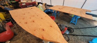

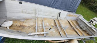

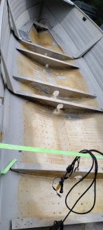

Hello everyone. Well it's been some time now. got a little bit done. got the floors and what not all cut out. floors are being stained/sealed now with the O.T.F.... Got the boat all cleaned out and pressured washed. old flotation foam gone. And that brings me to my next question. I know 2 part foam is best. But im not sure if i could manage. What if i over pour, and need to cut some off. is that not closed cell anymore? I was thinking 2" styroform insulation board. but not sure if that takes on and holds water.
also is it 2 coats of o.t.f and 2 coats of spar varnish afterwards? the screen-shot i have only says one of each. huh. lol....
also i found i had a hole that has been patched, or more like brazed or something. because it's metallic. i did fill the boat with water. had no leaks anywhere, including the metal patch work. but i was still thinking maybe cover it with so 3M 5200 (maybe drown it in it?, lol). i would think that would help. Thoughts?
