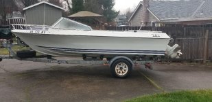

I enjoyed your story so far. I am restoring a 1981 Glasply from a Volvo I/O to a bracketed outboard. My stringers and floor were fine, did an infill and now have the bracket and new Honda hung, but not tested yet. Interior work now ready to restart after a winter off.
