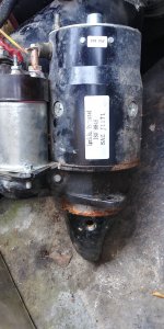

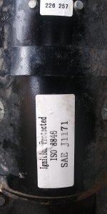

In order for us to help advise you, we need to know what that engine is connected to, between it, and the propeller. Using Achris' photo, what set up do you have? It is not an outboard.
Teldred
Aug 17, 2021
6
Yes my boat is defiantly a sterndrive and my engine is definatly cranking over the wrong direction
Teldred
Aug 17, 2021
6
That is the starter i just pulled out of my boat it has been replaced before i baught the boat and the two owners before could not get it to run they thought it needed a distributor but ive put all new parts in it and am getting spark it still would not start so when i verified the firing order online it said my rotor spin in a clockwise rotation but mine when cracking it turn counter clockwise so my starter must be my problem thank everyone who has helped me learn about my boat thank you so very much i was so lost
