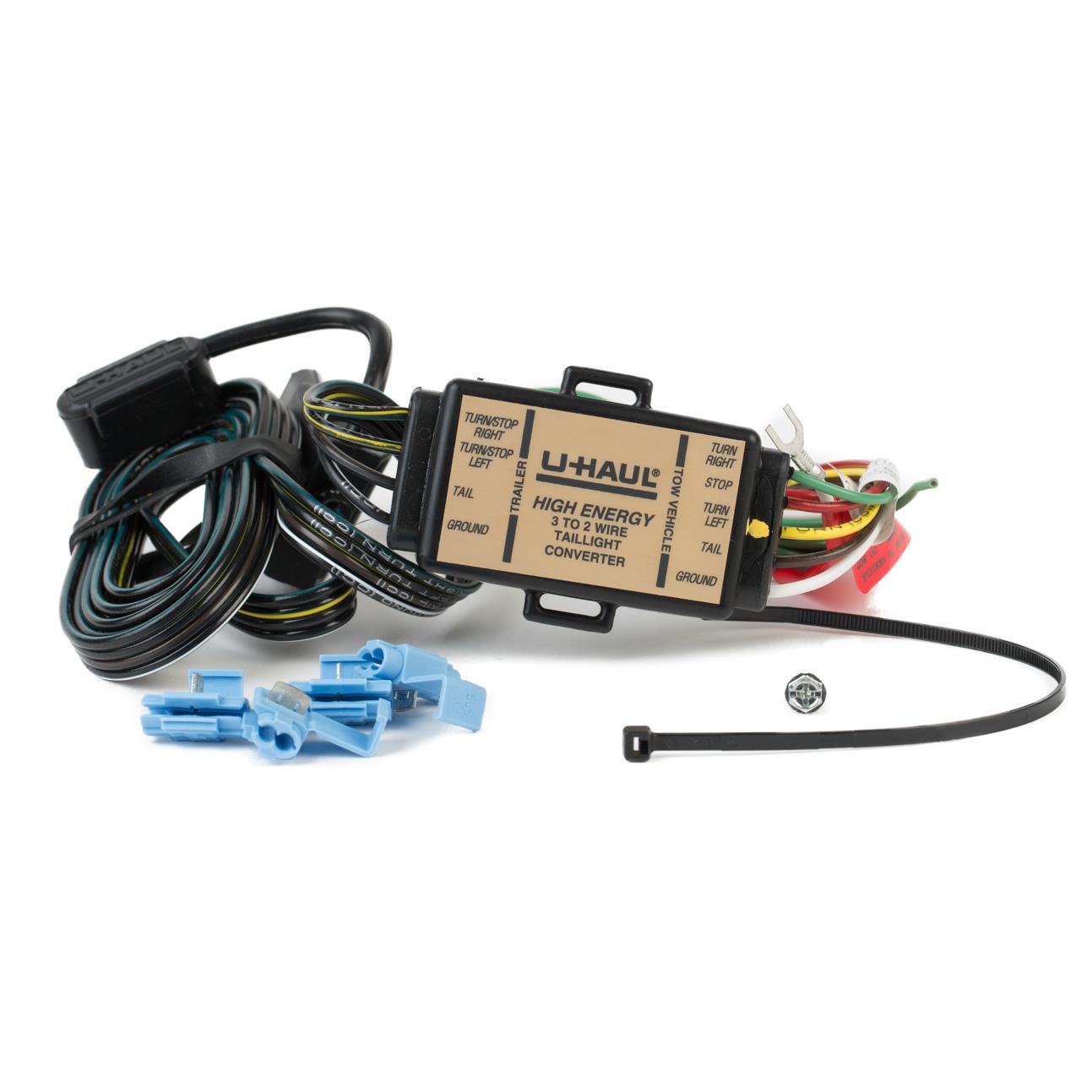

I am trying to install the wires for my 2015 Dodge grand caravan se. The wires is bought from U-hual and its part No. 14486. The instructions is following, https://www.uhaul.com/MovingSupplies/Image/GetMedia/?id=13684&media=5663&doc=1
I marked the dodge caravan tail light with 1 .2 and 3 section, Which section should I try to connect?
Currently tried to connect the trailer wire from the section of 1 , but it seems fails.
Thank you so much

1 & 2 are probably your blinkers and brakes right? Those would be the ones to tie into. 3 is more than likely your reverse light which since you're only hooking up a 4 pin converter box is unused.
I'd start by retracing all the wiring and confirm which is the feed and which is the ground - as outlined in the instructions from U-haul. I'd also make sure your ground from the convertor box is a good chassis ground - clean the paint from under the ring terminal, reinstall ring terminal and bolt, then top coat with whatever paint you have to prevent rust.
This may be an instance where either paying U-haul to install OR going with the more expensive plug & play Mopar option might be a better option. Here's a link to Mopar's trailer wiring...

Today I went to u-haul and the technical tested it and found the package cannot fit my 2015 Dodge Grand Caravan, So I buy another one and it is easy to install.
Thank you everyone
