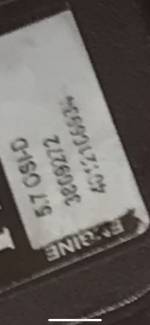

Can you read the attached alldodge ?

alldodge
Mar 8, 2009
43,998
Looks to e 4012106934 but it comes out to a GL-E so I'm missing something

Thanks for the number.
Your motor doesn't have the VST as I think ripjmk was eluding to, it has the standard high and low pressure pumps
