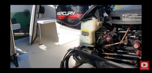

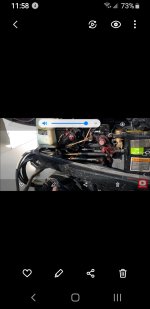

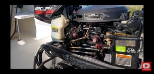

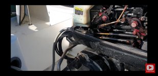

Any other ideas or thoughts after looking at the pictures of the linkage etc. I'm stumped. Beamer50

This is a picture of the same 40 mercury I found on YouTube, see how different the position of the trigger is , not touching the rubber stop ?
Beamer50
Jul 5, 2016
69
Picture off YouTube
