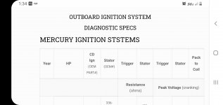

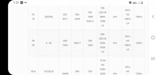

Here are the specs I can find online. 78 - 94 row 339-7452

This is how the chart reads

I reread your testing...you should measure the blk/yell to stator base and should read 3200-3650 ohms and the blk/wht should be 150-250 ohms.

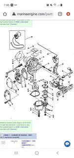

Is 16 the main jet? I am gonna do a rebuilt kit on this carb when I get more time but for now I will take her easy on it. How about spraying some seafoam in the carb? Think that will clean it out? 🤔
