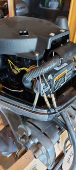

I've attached 4 pics showing the existing wiring setup from the old merc controller and the cable ends from the new mercury controller. I found the 5 pin cable you refer to. My first question is what the 3 wires are for on the left side of motor in pic. They are tan/black stripe, tan/white stripe, and purple. They are all currently plugged off. My next question is the 4 separate wires that are in addition to the 5 pin connector at controller are the same colors as the 4 wires that will be with the 8 pin connector once attached at motor. Do these 4 wires simply get connected together? I believe 2 of them are for the tilt/trim function...

The blue/white and green/white next to the male pin would be for trim/tilt. They would connect to matching color wires at the motor. The brown is likely for temp gauge. Another one is likely trim gauge. Not sure about the other. Your engine may not have senders for trim gauge and temp gauge. You will need to check.
About the other wires...tan/trace is usually an alarm sensor of some kind. Purple is ign power. it looks like your motor has an ECM and therefore different electronics from the older motors. You should get a wiring diagram for your exact motor. You can look on the maxrules site and see what they have.
